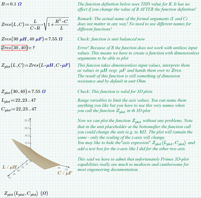

Apart from the unit mismatches Luc was pointing you to (could it be that it should read R^2 under the root and not simply R?)  and apart from the strange function definition where you use a range on the RHS of the definition (which can't work) you have to be aware that in Primes 3D plots units ar allowed only for the values on the z-axis.
So the arguments of the function you try to plot must be unitless, only the function result is allowed to have a unit.
So if you work with units (which you should do) this means that the input values for your function have to be dimensionless which also often means that you have to define a dummy function (based on the original function) with dimensionless arguments just for plotting.
Here is an example:B.png
What the plot does not show is, that the x-axis is a length in cm and the y-axis shows a length in m.
But as a first step you definitely should correct your formulas, making them unit consistent.

You should have looked more closely at example in the picture I posted in my last and read the explanations.
The ranges you use in 3D plot for limiting the axis must be dimensionless!
Your ranges still have units
And the function you use for plotting must accept dimensionless arguments.
Your plot function does the opposite! It accepts arguments with units, strips off the units and then calls the original function which expects proper units and would therefore fail badly.
The attached file (format P5) should help.
