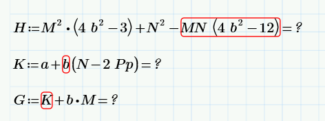

Hello everyone,
When I was writing an equation, I got the message "Units are not compatible"
Can someone help?

@_0 wrote:
Hello everyone,
Can someone help?
In the equation for:
  • H you've typed "MN" instead of "M*N"; the variable MN doesn't exist.
  • K you've typed "b(" instead of "b*"; the function b doesn't exist
The equation for G is OK after changing K.
In such situations, try copying each additive subexpression and evaluating.   That often shows the root cause of the problem.
Stuart
(To:StuartBruff)
Yes, but MN is interpreted by Prime as unit MegaNewton and thats the reason for the unit mismatch error message 😉
