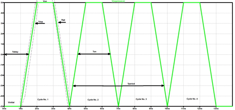

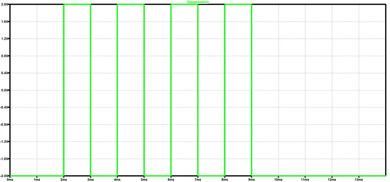

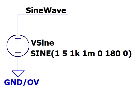

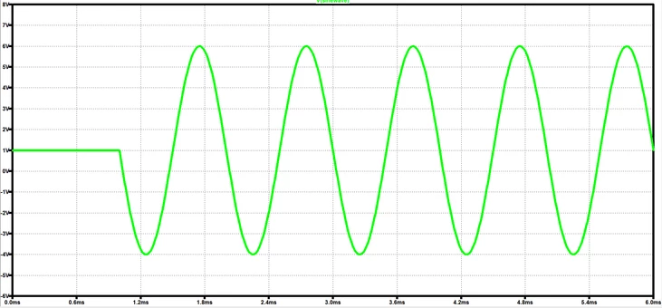

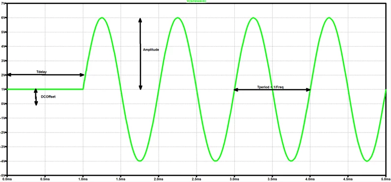

Hello Dear Friends,
Do you have any idea how to implement in Mathcad 15 the functions that generate the following graphs shown below?
Case 1:
And if I change the parameters:
Case 2:
a)
b)
c)
Case 3:
Thank you.

Cornel
(To:LucMeekes)
All 4 points listed by you, if it is possible.
The first 3 would be the main ones.
If it exists symbolically then by customizing the values ​​it can be evaluated numerically, and then it can be plotted. But I have no idea yet how to build these functions.

Cornel
(To:Fred_Kohlhepp)
I do not think that the rank can be an argument that resolves things or the rank is protected from the problems or questions:))), neither diploma of a faculty does not make you a successful/great engineer:) or at least an engineer who has unanswered questions.
Until now, whatever topic I opened I posted what I have done so far.
For this thread, I do not have a Mathcad file because I do not know how these functions can be realized, how they can be thought.
What I want to obtain is some function(s) in which I input these parameters (Vinitial, Von, Tdelay, Trise, Tfall, Ton, Tperiod, Ncycles) and so on for the other shapes/graphs within this topic, and at the end of the story, these functions help me to reach at the output graphs, as shown in the figures in this topic.
I don't think that's that simple to do. This is the reason for which I posted this message.

sine and cosine waves of course are built in. i meant other types of wave forms. it would be nice to have a built in drop down box of all sorts of periodic waves that you would just specify the parameter to. really have no idea why this was neglected in the program in the first place.
Cornel
(To:prop_design)
@LucMeekes  @Fred_Kohlhepp  @prop_design
The sine and cosine waves were just for example to shown how to arrive with the case 2) point c).
It's not really about sine and cosine waves, but as you saw and intuited very well...it's about other types of waves like case 1 and case 3 (and perhaps other types of waves, more or less general types that are extensively used in various domains like electronics engineering).
And how to parameterize such waves to make life easier.
Good point.

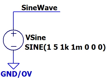

LucMeekes
(To:Cornel)

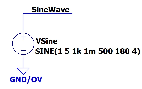

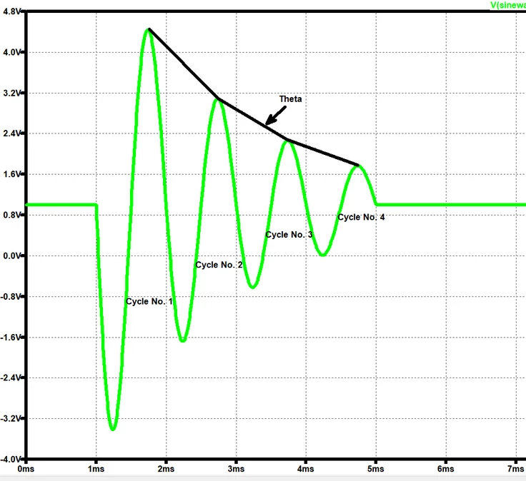

Well, here is a first shot, for the sine wave(s). Parameters as listed in your picture.
It's Laplace transformable:
And of course it plots all Spice's sine wave variants:
Evidently, you can apply units as you like.

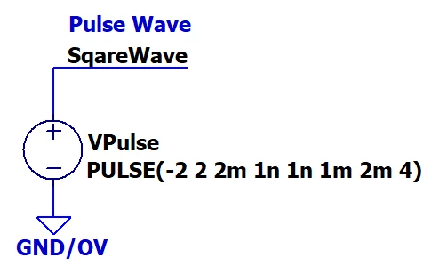

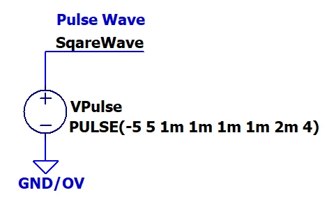

(To:Cornel)
Here is a function for the pulse wave for you to start with.
The function takes the same arguments in the same order as shown in your screenshot. However, the times that you show with arrows in the first picture "for clarity" seem to be quite inaccurate and misleading.
(To:Werner_E)
Here is a more compact version of the function posted above.
As you can see in the last example, symbolic operations won't work when used with units!
EDIT: See below.
EDIT My fault. The error occurs because I redefined t to be the range for plotting, should have used a different variable name (normally I use "t." in such cases as it looks like a normal "t".
So you see that the symbolic also works with units, but I can image that a useful result often will be demanded too much. As you should know the symbolic does not know anything about units and treats them as unknowns.
Cornel
(To:Werner_E)
Good.
Thank you very much.

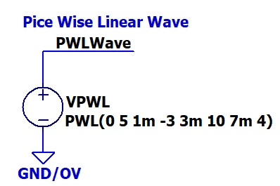

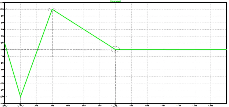

I dare to ask if the following options would be possible:
(To:Cornel)
It seems that in your pics you are using Tfree for two different things!
The more different parts your signal should consist of, the more summands you would have to add to f(t) in the function and the more arguments your function will get.
Unfortunately we are not allowed to create functions in Mathcad which can be called with a variable number of arguments. So it may be a better option to provide vectors as arguments to the function. The first vector could consist of the times (T.1, T.2 etc in my function), the second may indicate the signal value (constant or ramp; nor sure how to implement that).
It should be easy to create that kind of function for the piecewise linear function PWL you showed in your initial post - first vector consists of times, second vector of the associated values.
Give it  a try and come back here if you got stuck.
EDIT: Actually all the signals you showed in your last post could be created by a PWL function by adding T.delay, T.period and N.cycles as arguments to repeat the signal a couple of times. The times you would have to provide would not be T.rise, T.on, T.fall, etc. but rather the sums of those. You may also consider to provide the times as given in the vector and let your function do the summing - similar to what I did in the second version of my function when I calculated T.1, T.2, etc. just to save space.
