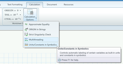

It can help in that case if you turn on the option to use constants and units in symbolic calculation (-> Calculation options).
But take care of your mass variable m. Chances are that it will be auto-labelled  as unit meter.
