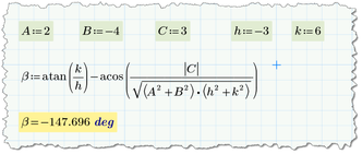

So the input values are A,B,C, h and k and the value you are looking for is the angle beta (one of the two solutions possible) as given in the in the first answer of the stackexchange thread you point to?
Sure it would be easy to do in Mathcad or Prime,
but it should be as easy to do in Excel. Excel offers ARCCOS() or ACOS(), ARCTAN() or ATAN() and the square root SQRT. What else would you need more?

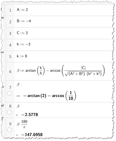

If you are looking for a free calculation program you may want to explore GeoGebra (Classic 6 or 5) -> https://www.geogebra.org/download
BTW, I also wonder if A,B and C really are the most natural input values for your real world problem.
I also wonder if the formula given in the stackexchange thread is fully correct. It sure misses the absolute value of C and it only returns one value while the task has two solutions.

Concerning the formulas from the stackexchange thread a few remarks:
1) As already mentioned when it comes to the calculation of R it should read |C| instead of just C
2) Instead of arctan(k/h) you should use ARCTAN2(h,k) or ATAN2(h,k). Otherwise you would get a wrong result in case h is negative.
3) the formula in (3) gives you the angle of the moveable cam with respect to the horizontal line pointing to the right (as usual for polar coordinates). Hope this is the angle you need. You get the second possible solution if you replace the minus in front of arccos for a plus sign.

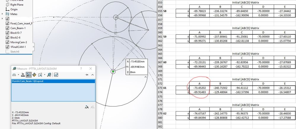

I cannot seem to get it working right.
I tried the method below and it works perfectly, but I would need to use a solver for x(Q) in excel.solve.png
Not sure why the stackexchange eqn does not work or what I've done wrong with it.

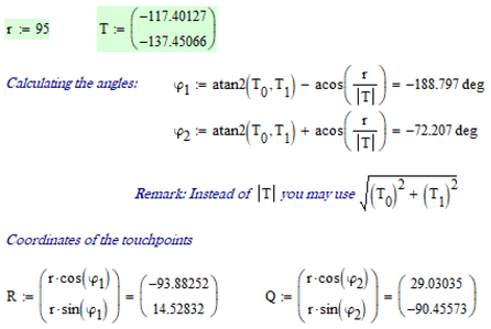

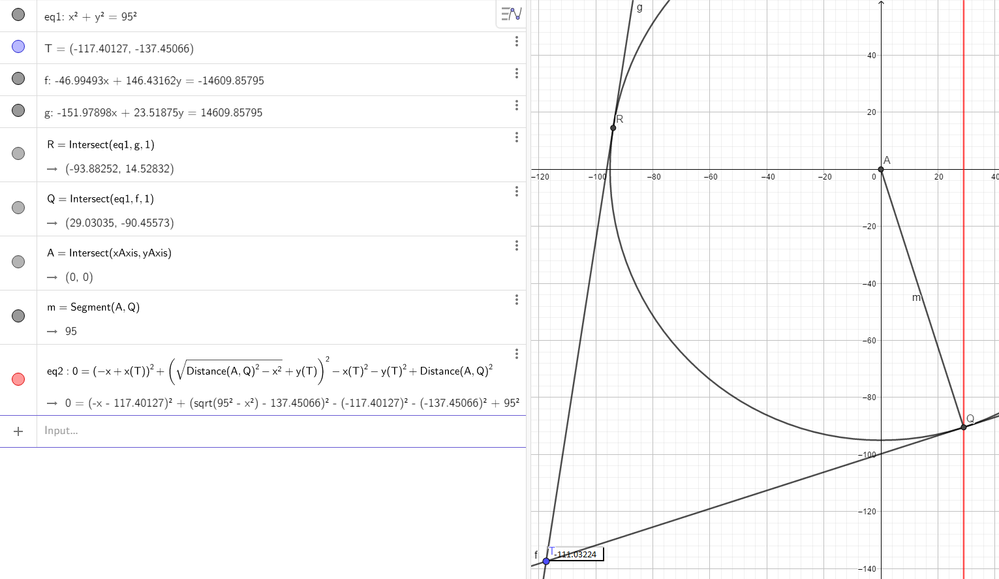

I have no idea what you think that is not working. I don't know what the last equation in your screenshot should show.
When I assume r=95 and the coordinates of T, the formula from stockexchange gives you both angles (see my remark about the second solution in my answer above) you asked for.
If you need the coordinates of R and Q - thats quite easy to accomplish. See the screenshot of a Mathcad implementation. The results are pretty the same as what I see in your Geogebra screenshot.
AS explained in my previous answer - because the abscissa of T is negative it is important that you use ATAN2 (or ARCTAN2) and not atan (or arctan).
It should be easy to implement the formulas in Excel and there is no need to solve an equation.

Absolutely incredible.
Thank you very very much, it works perfectly, took about an hour to plug it in but now for every design change the results are instant instead of the hours it took before.
