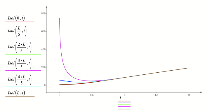

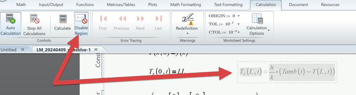

Dear PTC Community,
I was recently working with a Mathcad Prime 9.0 worksheet that uses the Pdesolve function, but what I can't seem to do is define a first-derivative boundary condition (Neumann condition) in which temperature at the boundary is one of the arguments.  I get the error message "Bad algebraic constrain."  I've attached a zip file containing the worksheet.  If you can, please help me troubleshoot this issue, or else let me know that what I'm trying to do is not possible.
Thanks for your time!
--Bob

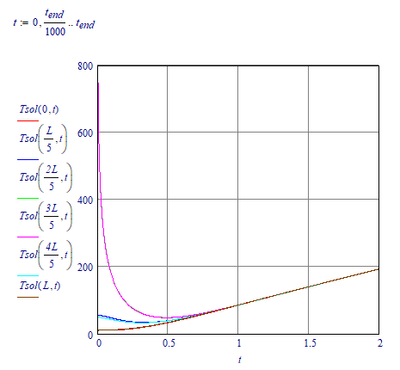

Hi Bob,
This is what I get in (good old) Mathcad 11:
I don't think this does anything different from what you are trying.
Possible pdesolve in Prime is not yet up to standards.
I've attached my sheet. Try to create an html file from it, using the sheet translator.
If it produces a similar result, then Prime should be able to it too. In that case translate my sheet to Prime  and run that.

(To:rjwolfgang)

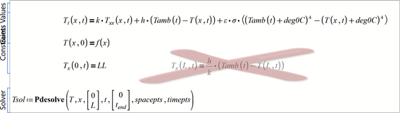

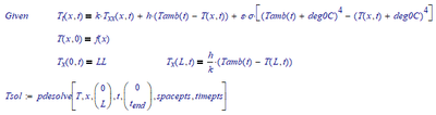

Lucs sheet works equally well in Mathcad 15 (creation of vector X has to be done a bit differently, but thats no big problem).
After converting the sheet to Prime format, Prime throws the "Bad algebraic constrain." error you already have seen.
After disabling the constraint crossed out in the picture below it looks we get the same solutions as shown in Luc's sheet !?? Not sure, though.
rjwolfgang
(To:Werner_E)
Wow, that's fascinating!  How did you "disable the second constraint".  It shows up in Prime as being "grayed out", but it's not obvious to me as to how things are disabled or enabled.  Is there a menu item for that somewhere?

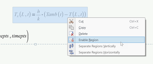

(To:rjwolfgang)
You can either disable a region via the menu (Calculation ribbon)
or you can use the right mouse click menu.
Unfortunately this menu does not show up when you simply click in the region. You rather must "fence" the region so that it gets blue for the right click menu to work.
Of course you also could simply delete the region if its not necessary 😉
But I guessed that this  constraint would be there for a specific reason ...
rjwolfgang
(To:Werner_E)
Thanks for the tip, Werner!  I appreciate your time and patience!

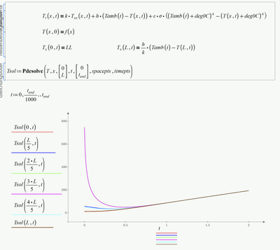

It appears that Mathcad 11 is equally happy, without that third constraint:
I guess you have to understand the (physical) situation to explain why that is...
(To:LucMeekes)
I just tried your converted sheet in Prime 10 and activating that third constrained did NOT result in an error:
So PTC seems to have fixed it.
