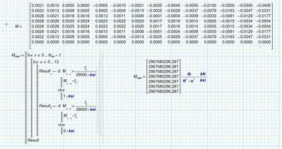

I'm attempting to use conditional formatting to determine whether values meet certain criteria within a matrix, and then based on those results, manipulate the values within the matrix by certain formulas embedded within the if/then statements.
Right now I have the contents of the original matrix (output from the embedded excel file), and I'm attempting to use a separate variable (Mcalc) to use step functions to move in both directions within the matrix to identify each value within the matrix to confirm whether it meets certain criteria. I believe I'm getting hung up on the portion where I'm trying to use two separate step functions within the definition of a single variable.

Your matrix M is 49 x 14, but your program seems to only deal with the top 7 rows.
Furthermore I don't understand why you use two if-statements, the only difference being the 1 ksi or 0 ksi in the else branch.

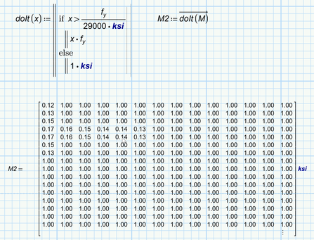

From your verbal description it looked to me that you simply want to look through all elements in the matrix and depending on its value replace it by some other value.
Here I use your first if-statement and apply it to every element in the matrix
In case you only want to treat the first N.As rows, you could do it as follows
But the rows after N.As contain only zeros anyway
