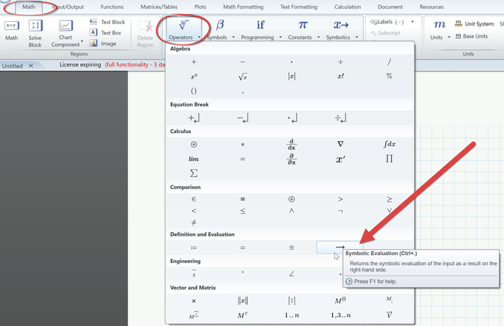

I tried to output the calculation result. The ideal result would be like: "ps = k tp + b "according to the "IF processing". The "tp" here actually relates to the time, but right now I just want the result to be like the form I mentioned above. In other word, I think and hope the "tp" is just a symbol in my ideal output result.
So I tried to set it as a  "key word" or "constant" by setting the labels but found nothing helpful. Can any solution help me with this? Many thanks advanced !

If you expect a symbolic result (as tp is an undefined variable) you have to use symbolic evaluation and not numeric (the normal equal sign).
Is it this you are looking for?  No need the re-label tp as Keyword or anything else.
Number of decimals is per default 20, You can limit this number using the "float" keyword. But keep in mind that doing so also affect the precision of the calculation, not just the display of the result.
Symbolic evaluation:

THANKS! It does work!

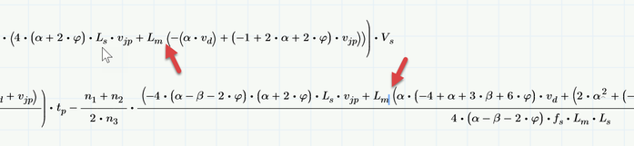

Oh by the way, would you help me with another problem that I post on my reply above? About the error "This value must be a function". It happens when I change the ξ from 0.5 to 0.85(on the first page of the sheet), which respectively relates to the case 4 in the function "ps(tp)". Similar things happen when the coefficient ξ is changed to 0.15, as case 2.
I have checked the relative post about "This value must be a function" in the community but found no error similar to mine. It seems like a small error but I just find no clue. Is it because I didn't complete all the judging statement that made the "if-else if" statement not work? Or because I make a separate branch in both case 2 and case 4? Or other small mistake that I don't notice just like the symbolic evaluation problem you just help me out.
Many thanks advanced! You have help me twice on this subject!
(To:DDHH2001)
When xi=0.85 you fall into case=4 and here you wrote
There is no multiplication between Lm and the opening parentheses and so its interpreted as a function call. And because Lm is not a function but a simple variable, the error is thrown.
You have the same error in the calculations for case=2, too.
Add the multiplication operator and the function works as it should
Its a pity that the Error Tracing (calculation tab) is flagging the whole function body and not the position where the error actually occurs. So its rather useless in this case.

Missing multiplication signs.
You are UNBELIEVABLE amazing! Throughout this project, you helped a rookie for three times!  I wouldn't imagine how terribly crazy I will be without your help of pointing out the missing of multiplication sign.
I think this may be accounted for my latest learning of another software, Mathematica, in which a multiplication can be replaced by a blank. These coefficients I write in the sheet of Mathcad are calculated in MMA. I mix them up.
