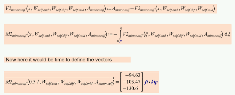

It may be a good idea to set up the whole sheet in a quite different way.
First define the necessary calculations via function with all variable values as input arguments. Don't define any vector values yet.
Later you can call those function with the vectors as arguments and of course you should vectorize the function call.

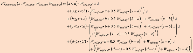

I did it with the functions necessary for the integral, starting with
and continuing with
Voilà!

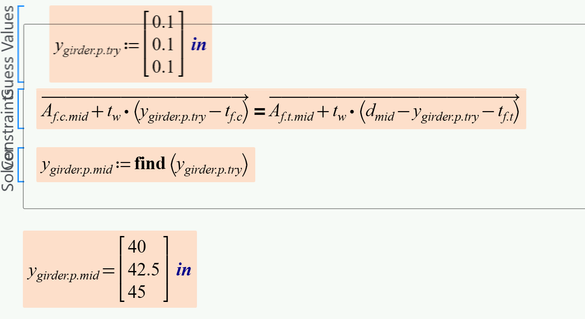

According the solve  block all that is needed is to provide a vector as a guess and vectorize both sides of your equation:
6 REPLIES 6
You cannot use elements of an array as arguments to the Find function in a solve block.
You can use multiple expressions in a solve block though:
with as result:
and continuing with
Voilà!
