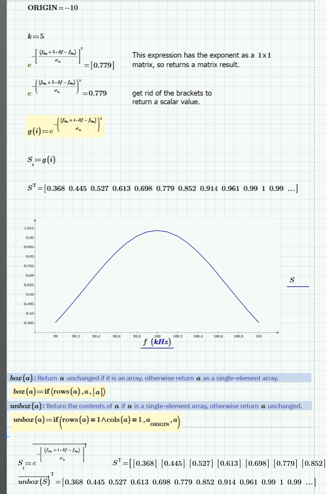

Your exponent is a 1x1 matrix (or vector, depending upon your outlook).  Consequently, the result is a matrix.  Get rid of the bracket, and all is well.
Alternatively, I find the function unbox, and its counterpart box, to be helpful on several occasions

OMG, I’m so used to thinking that [brackets] are the same as (parentheses), just at a “higher level” of nesting. But of course you are right – brackets in MathCAD indicate an array, NOT like parentheses. Thank you so much!

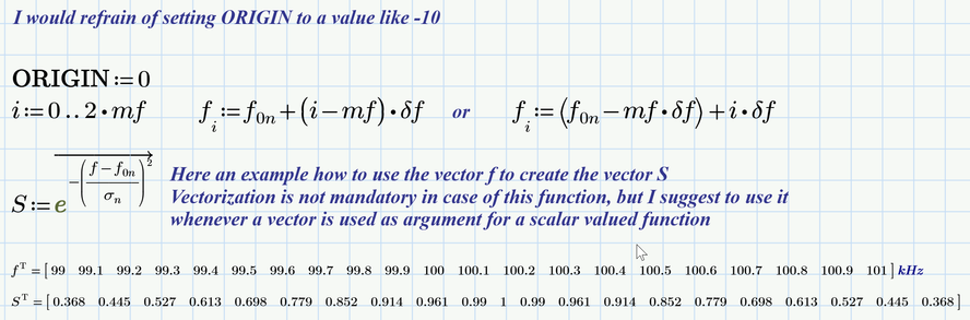

Stuart already explained the main problem: Don't type a square bracket unless you really want to create a matrix/vector.

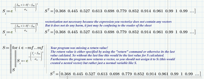

Here is your fixed  Prime 9 file attached
I would also suggest not to set the ORIGIN to an unusual value like -10 just to make it a little bit easier to create just one vector (f).
I also would suggest to use the vector f itself when creating the vector S. Vectorization may be done automatically in case of the expression you are using but may not with other expressions. So its a good idea to always explicitly apply vectorization whenever a vector is used as argument in a scalar function - just to be on the safe side.
