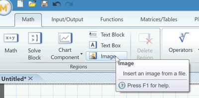

Did you try the "image" button to insert an image?

Yes.  image button then prompts to browse for file and inserts picture.  But this is not embedded link.

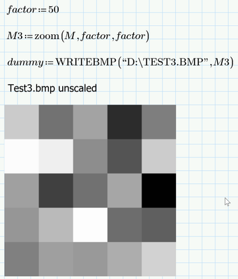

Maybe a crude workaround for you could be to scale up the image before saving it you you don't have to scale the inserted picture in Prime. I guess that there still would be some antialiasing but much less noticeable.
EDIT: Ooops, I had forgotten that we can use the built-in "zoom" function to do the resizing of the picture matrix:

It's a good workaround.  But it's only hiding the effect visually at the borders right?  Also, a large image would have to be stored 50x50 larger.  All not very desirable.

I am not quite sure if the workaround is just hiding the effect visually. It could be that the antialiasing only is done on the fly when you enlarge the picture in Prime. So when you just insert it without rescaling it afterwards, maybe no antialiasing is done. But then, I am not sure.
