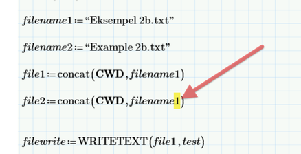

Why isn't writetext working in programs?
Could it be that your problem is a simple typo? Shouldn't the "1" highlighted in the picture be a "2"?

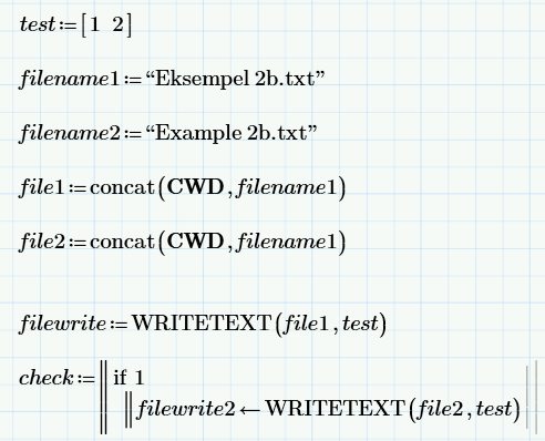

I see no error (message) in the picture you provided. Please provide (also) a worksheet.
You only defined the 'check' variable in terms of a (little) program.

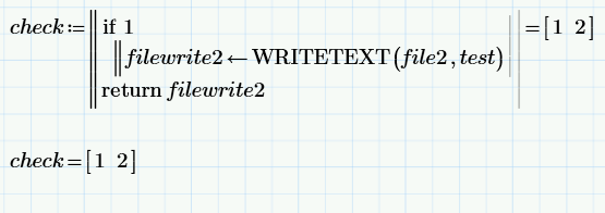

In order to actually execute the WRITETEXT function in that little program, it must be evaluated. Did you try evaluating check yet?
To evaluate check type:
check=
No success here so far...
This (picture) does not show it is not working (neither that it is).

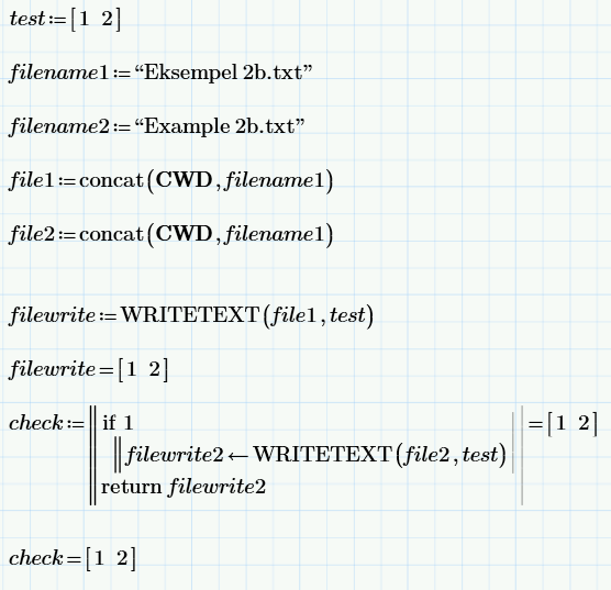

I'll post the whole testfile once again.
The file contains 2 files that should be written. The first one is written regardless of the check, and it actually is in the folder.
The other one in the program is not written, though it should be in the same folder.

The problem is, that I haven't managed to write to file if the code is in a program component.
YES, it could be as simple as that!
