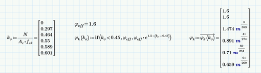

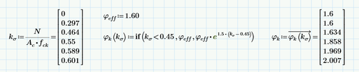

I have two identical scripts with identical input data. However, the output vectors differ. What is wrong with the second one??

The 'scripts' are not identical, apart from the definition of phi.eff (1.6 versus 1.60):
The first one uses e, the base of the natural logarithm in the expression for phi.k.
The second one uses a variable e, the value of which probably has a unit of metres m.

Thank you so much! The e-base solved the problem 🙂
