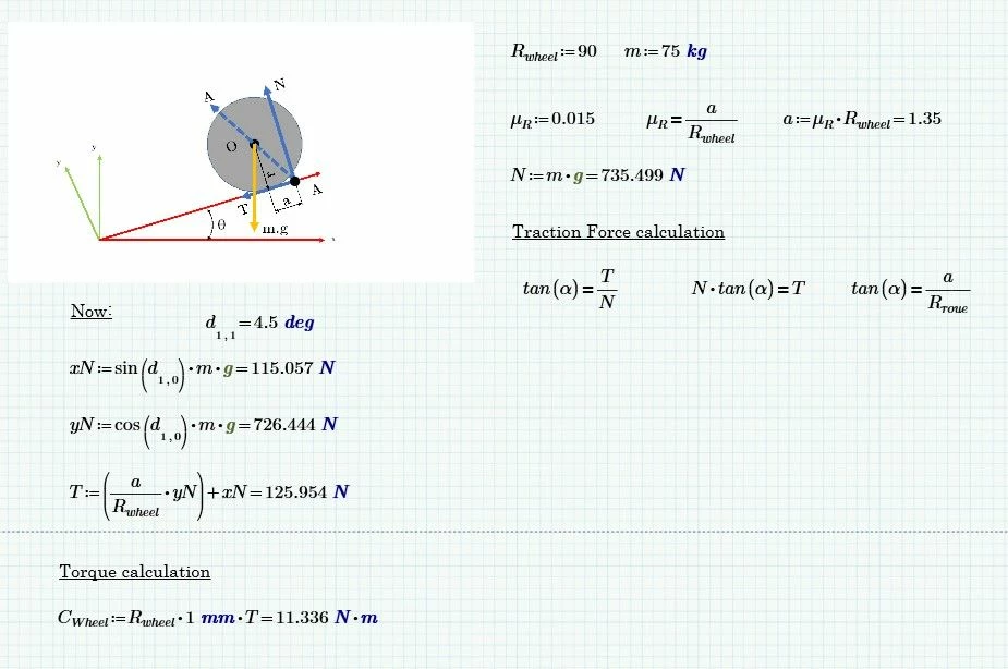

I need to calculate a drive torque for a wheel climbing a ramp.
i can calculate this,  but my worksheet is not elegant and is heavy 😥 (probably, i'a m using matchad programmation not correctly)
Here is now i do

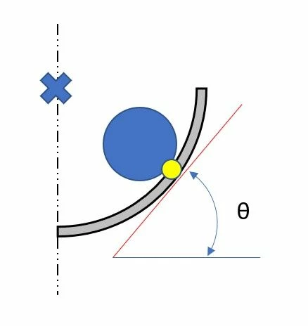

The ramp is cylindrical profil

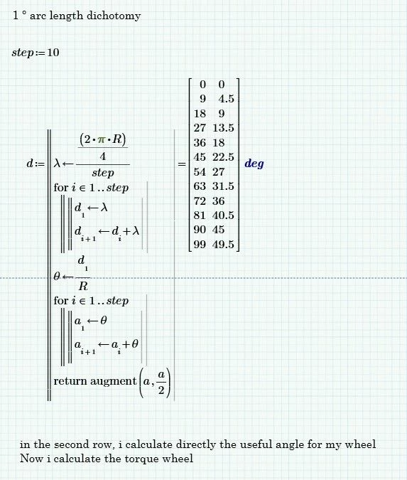

now, i dicotomize a ramp ( arc lenght)
In second time. At this step, this is a mechanical problem
I assume the ramp angle is simply a/2 .

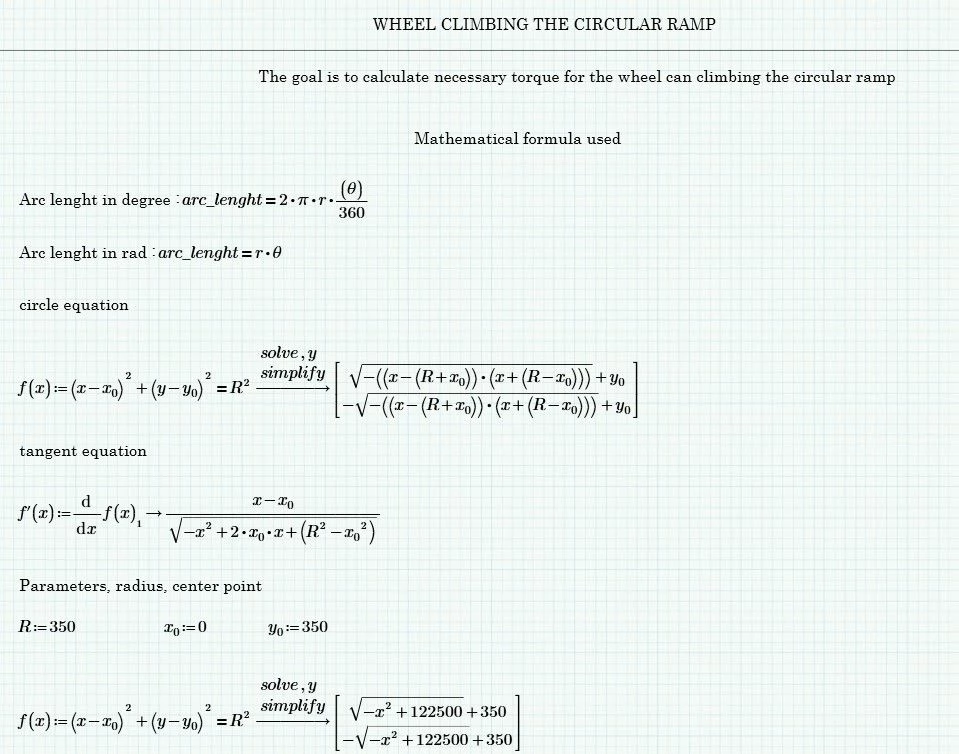

In fact, the ramp (red line, on the picture) is the tangent equation at the circle. the first point where we calculate a tangent is calculate with polar coordinates from dicotomized values.
I think my result its Ok

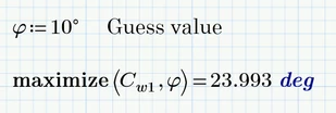

Best answer by Werner_E
The maximum is not exactly at 22.5°:
Good thing that we have functions 🙂

a/2 🤒  just a is ok
but how to do exit red value
