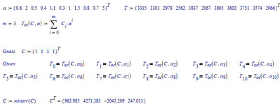

Hello PTC fam,
I don't know where did I do wrong in this programe.
the question is
Determine least square method value of coefficients Ci( i=0,...,m) in polynomial form.
Calculate the approximation error  where m=3
Please advice.
Adlil
LucMeekes
(To:Adlil)
Did you mean to do this:
Then:
Finally:

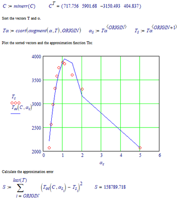

But there are options for minerr. If you press the right-mouse button on it, you can select other minimisation strategies. The above was done using 'Linear' (The default). For non-linear: Levenberg-Marquardt you may get:

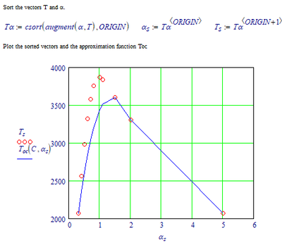

Your sheet does not explain well what you are trying to achieve. Apart from that:
1. The summation for Toc in above picture goes from i=0 to m, when m=3, that means you should get C as a vector of 4 elements. Your sheet shows you calculate a vector C consisting of only three elements. The input for that calculation (matrix A and vector B) do not seem to be related to alpha or T.
2. Instead of the solve block, you can use the lsolve function to determine C from A and B:
3. What is the vector K calculated for?
Then:
Finally:

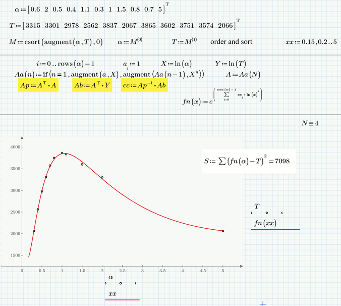

I've been playing with this.  A direct least squares fit to this data with a third order polynomial isn't great.  But a fourth order fit to the natural logs looks pretty good. (My apologies for diverting the discussion!)  Sheet in Prime 4.0 Express.

Here is a screenshot of Freds work (I just omitted the grid which can be achieved much easier in real Mathcad)
You can also create his function using Mathcads built-in polyfit function.
Here a comparison of a rational fit (f1), a polynomial fit of fourth order (f2) and Freds approach (f3).
According to the sum of squared errors the polynomial fit (f2) would win, but I bet you don't like the curve in the range from 2 to 5. So I guess that Freds approach rules.
MC15 sheet attached
