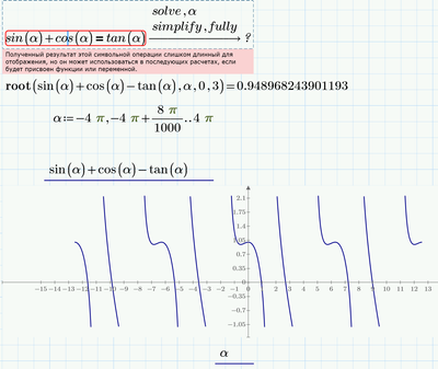

Why not!? Can you show the symbolic solution?
ValeryOchkov
I show to my sdudents the equations sin a + sin a = tan a
99% say that it is not correct? But 1%...
See please

nd what about Mathcad/MuPAD
Your text "sin(a)+sin(a)=tan(a)" shows different from you mathcad sheet picture.

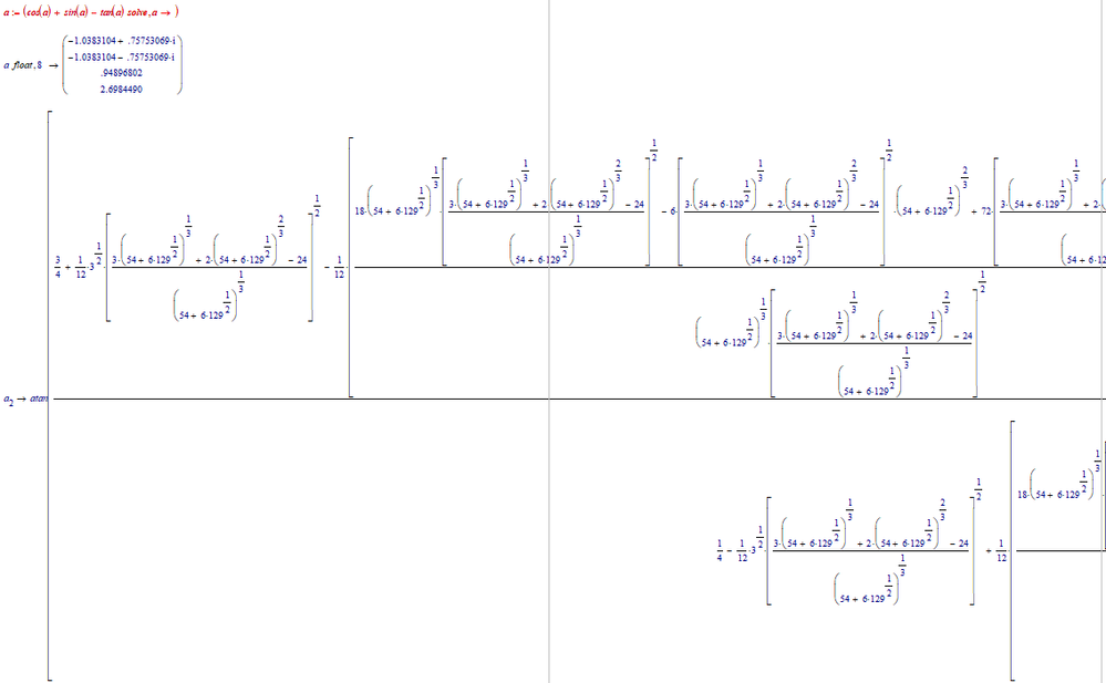

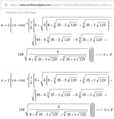

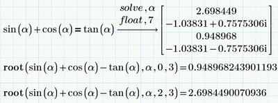

Because it's more intrigueing I tried the latter first:
Note that there are four primary solutions to this problem. (see the float results). I expanded the smallest real solution up to 2 of 5 pages..
I guess the size is the reason why Prime will not give you the symbolic result...?
(To:LucMeekes)
In Mathcad 15 all symbolic results are equally wide ("only" three page widths). Using the modifier "simplify,max" the result gets four pages width.
