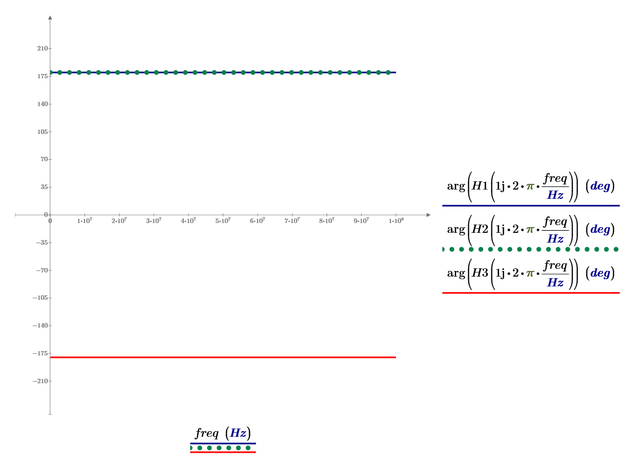

Why there is that difference in phase?
Cornel
(To:Cornel)
Just check the value
There is a very tiny negative imaginary part and so the phase is -179,999999... deg which for display is rounded to -180 deg.
2 REPLIES 2
LucMeekes
(To:Cornel)
Probably due to numerical accuracy.
(To:Cornel)
