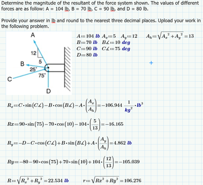

I'm using MathCAD 9.0.0.0. I laid our 2 sets of 3 equations. One set is using variables. The other set has the values plugged straight in. The set with the variables should equal the set with the values because the values are the same, but they don't and none of them equal the correct answer.
What should happen is...
Rx=Rx=-22
Ry=Ry=211.5
R=r=213
My MathCAD program is written to follow this example...
This is how my MathCAD program looks...
Ignore the 25 degrees and the 75 degrees in the diagram. This is a homework problem altered to match the example problem so I can test to make sure it works before plugging in the values for the homework problem. Also, I'm interested in fixing the "values" problems Rx, Ry, and r. I only created those to figure out why my variable problems Rx, Ry, and R aren't working. Attached is my program.

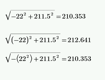

Something seems off with MathCAD calculation because even when I plug the "values" in the last equation...
...but when running this through Excel, I get...
212.6411
...which round up to the 213 in the hand written example.
     Brent
Be careful of what you're squaring ...

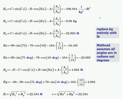

Thank you. That explains part of it, but I still need to resolve the rest.
I thought I tried that yesterday, but it all seems to be working today. Thank you!
No worries.  Is that all of your problems sorted out?
Stuart
I'm sure you've already been told; "lb" is not force, it's mass.  If you want force you use "lbf".
And you should know that mathcad does vector math, which can make this easy,
