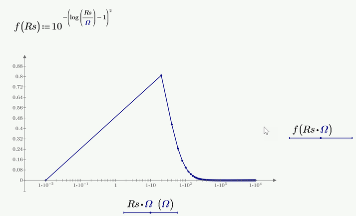

my Company forces me to switch from MathCAD15 to prime 10. Despite many other item I have question about logarithmic plots:
How can I set that the break points for calculation are also done on a logarithmic base?
It seems that the brake points still have linear steps --> almost no resolution on the low value end - even when setting "Number of Points" to 3000.

I can confirm that in Prime the quickplot feature (plotting without defining the abscissa variable) with a logarithmic ordinate axis is broken.
As you already suspected, the values still are spaced linear which is unusable.

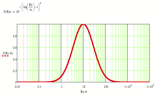

Mathcad 15:
The same in Prime 10 (using the default 500 points):

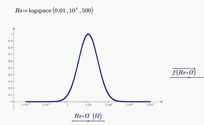

A possible way around this bug could be to define the ordinate values as a vector with logarithmically spaced values created with "logspace".
Here again using 500 points:
Vectorization (the arrow over the expression) is not mandatory in case of the function f used here but may be needed for other functions. So I consider it a good idea to use explicit vectorization every time you feed a vector as argument in a function written for scalar arguments.

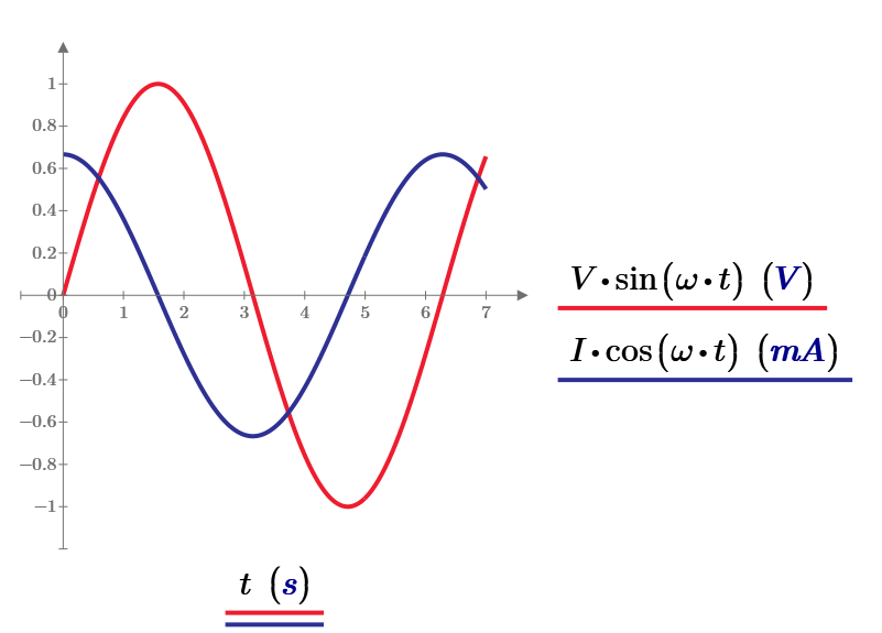

BTW, I notice that the picture of the MC15 plot you attached showed a plot using a secondary y-axis. Primes native plots do not provide a secondary y-axis (and no labels and no grid lines ...). PTC therefore, instead of improving the native plots, had integrated a third party tool ("Chart component") which has a second y-axis, labels, gridlines, but also its own drawbacks - apart from being really slow it does not know anything about units. If the secondary y-axis is mandatory you would have to use that Chart component to create the plot.

If each plot has different unit, you can plot all in one plot.

Different units in one plot are no problem but different magnitudes of values can be and may require a secondary y-axis or ... simply a second, separate plot. Most of the times showing the two traces in one plot has the only benefit of saving space and so its not a big loss to invest in separate plots.
I usually prefer separate plots because I find plots with a secondary y-axis harder to read and comprehend.
