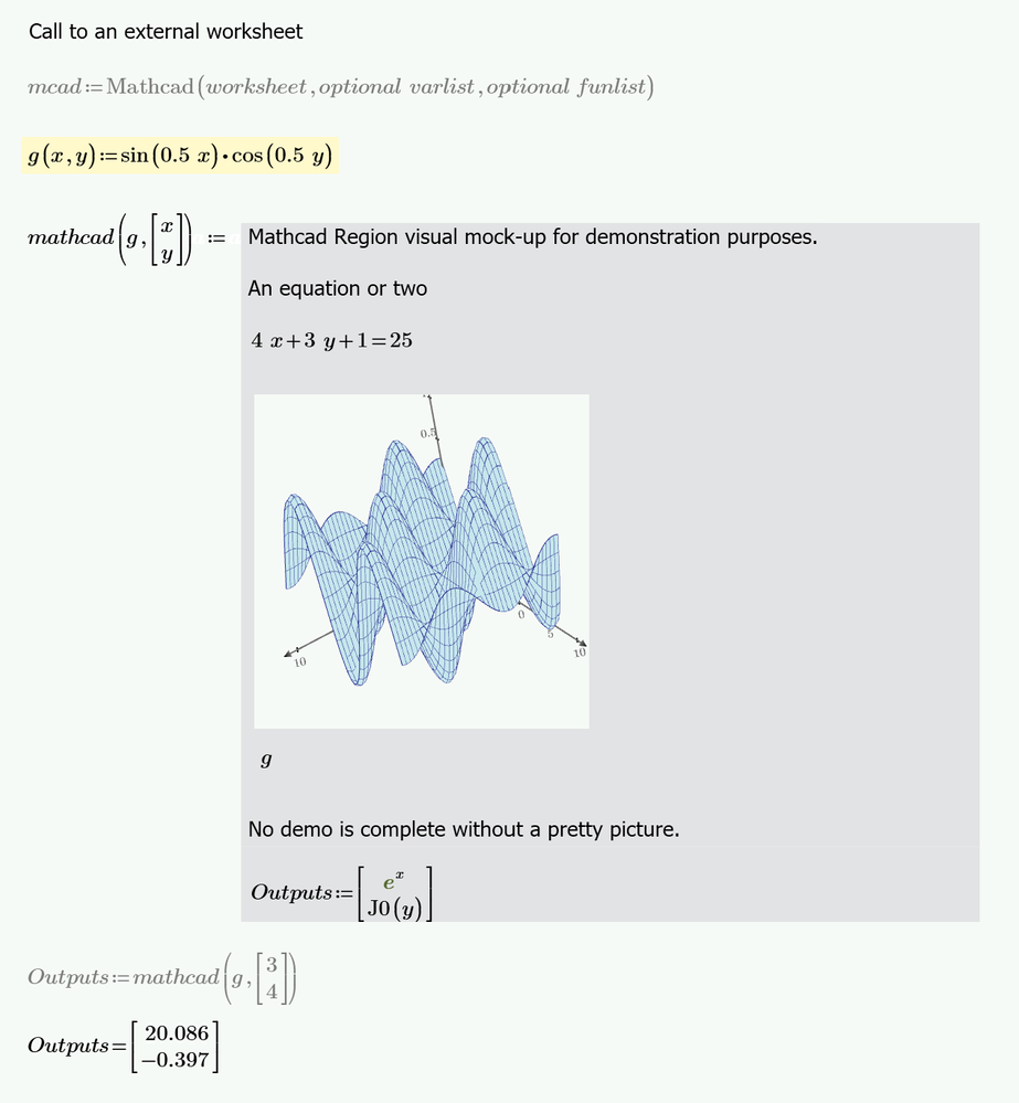

Yes, the Mathcad support team can add features like READMATHCAD.  Whether they will depends upon the perceived usefulness and priority of the feature request. It should be possible for you (*) to write an external program (e.g., C++ or C#) to get the matrix data via the Mathcad API. I don't know whether it's doable through JScript in an advanced control.
Even if the Mathcad support team regarded the feature as Usefulness Rating A*** Priority Immediate+++, you'd still have to wait until the next major version release for it to be available ... unless you were lucky enough to be asked to be a Beta Tester.
Although not quite the same, I suggested way back in Mathsoft Mathcad days that a worksheet would be treated as a Mathcad data type with a user-selectable return value.  The basic idea was along the lines of mcadMathcad(worksheet, optional funlist, optional varlist), so it is very similar to your READMATHCAD function.  IIRC, an extension was a Mathcad Region that would be a resizable embedded Mathcad worksheet, which would be completely editable as per Mathcad usual.  This would also have means of function/data input and output similar to what you see in an advanced control, except that you could call it as a function.
