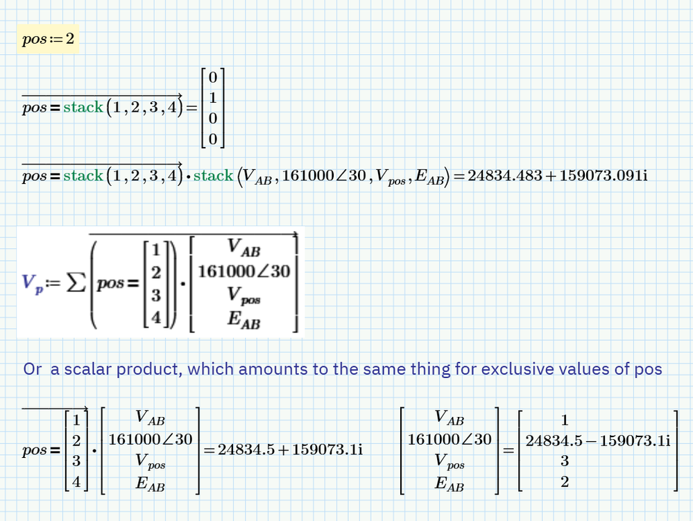

I have an old MCAD 15 program I am finally converting to prime.  Is there a short efficient way to implement those if statements in prime?  That VP is an intermediate variable used further down in the program.  Below is a snip showing the if statements.

Are any of these options of interest, Russ?

Very nice, thank you!

Another option is:
But why don't you use the legacy converter?
Or even just the dot (scalar) product ...
Stuart
Thank you, very interesting.   Also, I was ignorant of the converter - thank you!
