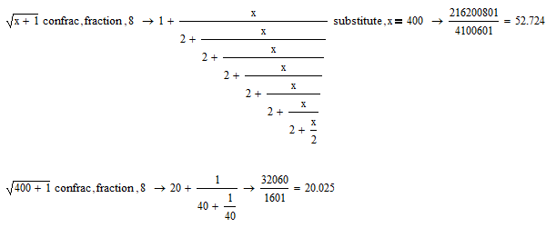

Try
f(x) := sqrt(1+x), confrac, fraction, 8 ->
Do you need separate functions for numerator and denominator?
A first attempt is shown below. Note that you don't always get numerator and denominator of the fully cancelled fraction that way.
It was necessary to change the accuracy parameter from 8 to 11 to get the same result as with the constant value 1 for x.
Unfortunately I see no way to make this accuracy value an argument of the functions so we are stuck with the value chosen when the functions are defined.
Note that the function return the same result as when using confrac with a specific value for x only for x=1.
So I guess these function are not of much use to you.
Reason can be seen here:
