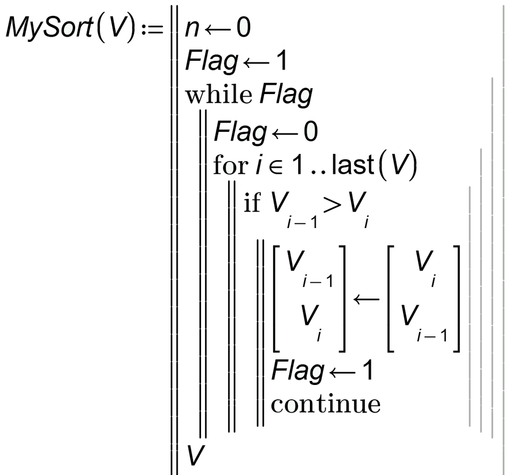

I have only one Mathcad-sheet with continue programming operator. I can show it!
But we can creat this program without the continue operator. But with the continue operator it is nice, fine, прикольно!
Do you have or do you seen a Mathcad-sheet with continue priogramming operator?

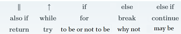

This is the new programming palet for Prime 8:
My own programming palet for Prime (fuzzy sets)
I think it is one in the over the World Mathcad program with the continue operator - and we can delete it!

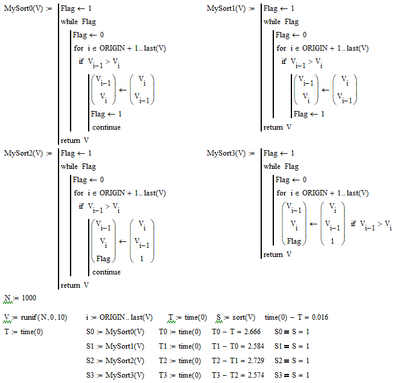

What is purpose of the assignment to n (the first statement of the program)?
The program runs with the same result, but faster, without the continue statement.

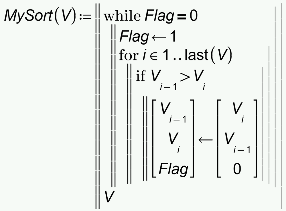

And it can be speeded up a little more by integrating the assignment to Flag into the vector assignment:

BTW, the program you posted in your last reply is missing the initialisation of variable "Flag" to zero. You can never know if there isn't a global variable "Flag" defined in the worksheet with a value different from zero. Your example shows that it would be nice to have the third kind of loop in Prime (do...while, repeat...until) available, but, alas, Prime does not offer it and so we have to find a way around using the loops which Prime offers.
