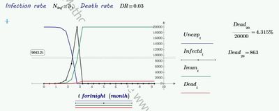

So here is my SIR model of the novel corona virus outbreak.  It's built in Prime 6.0, but I've attached a PDF for those who don't have the latest version.  I welcome any constructive comments and corrections.  I pray that someone finds something wrong with this model, but fear that it is fairly accurate.  The results are disheartening.

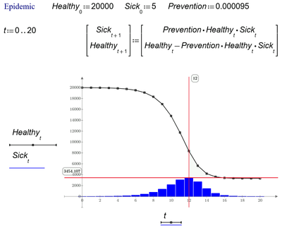

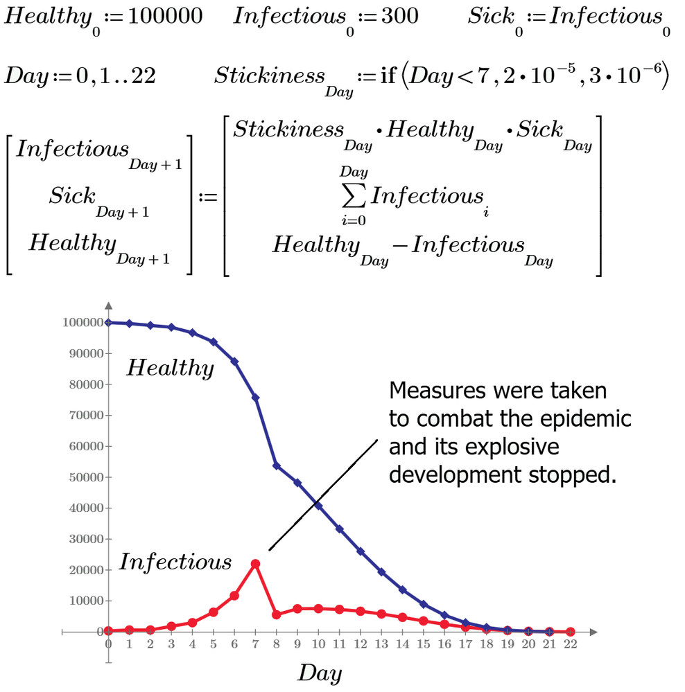

One old Mathcad-sheet
FredLusk
(To:ValeryOchkov)

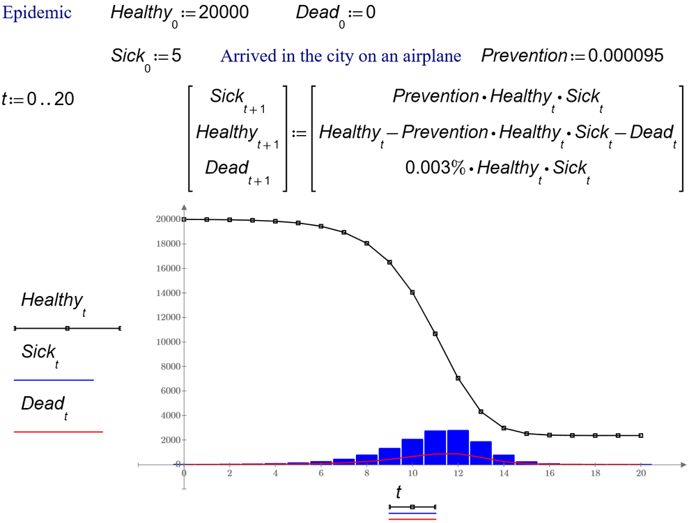

Shouldn't Healthy plus Sick equal a constant 20,005 over the entire range?  Or, is too sensitive a subject right now to mention all the poor fictitious people who died? 😎
Yes, the original model for the development of the epidemic was the vector Dead. But we will not consider sad cases - and so there is a lot of sadness in the world now. We assume that the ill people have received immunity, no longer become infected and none of them died.
Sorry, I don't like this model, but it did give me a place to start.  Attached is my attempt, a Prime 6 file and the pdf of it.  Looks like we're in for a tough year!
Nice graph!
If you play with the "rate of infection," the number of people that each sick person infects per week, you can see why the health care professionals are begging us to "flatten the curve."  If the infection spreads more slowly the peak number of sick people is less so the hospitals don't get swamped.
The timing of the pulse is also affected.  We can adjust these numbers as the data improves.

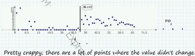

One of the problems I had with JeffH's original model was the number of people who died.  Supposed experts are estimating deaths to be between 100,000 and 200,000; the model predicts significantly (order of magnitude) higher numbers.  I researched the infected history in my country (USA) and used that to try to "fix" the model.
By manipulating equation 2, rate of infection, we can use this data to estimate Ro, (=b/g) .  Since gamma is reasonably estimated (most infections except the tragic ones tend to run about two weeks) we can improve the model.  (At least that was my assumption.  If we have N measurements by using the change between measurements to estimate the rate of change of infection, and have N-1 measurements:
Two observations were made:
  1. At the start, where the infected numbers are very small, the computation fails, and
  2. At the end of the measurement list there appears to be a definite downward trend; this corresponds to my country finally recognizing that there's a problem we need to address.

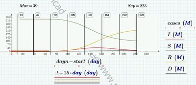

Discarding the front data, and recognizing the trend, I "guesstimated" a time-changing function for Ro (and therefore beta):
The mean value estimated from the data is Ro = 4.2, the value computed for the last data point is 1.7.  If we take that as the best mitigation value that can be achieved, the plot looks like this (vertical scale is millions):
With the mitigation we should expect almost 5 million deaths with a third of the population still left unexposed. And the Infection doesn't begin to subside until July, done by end of August.
