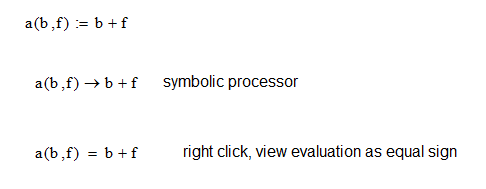

You can use the symbolic processor (in 14 aand/or 15) to do this:
Note that if you have assigned values to b and f you will need to put b:=b and f := f above the symbolic values.  If you right-click on the symbolic expression you can alter its appearance.
Exporting to a file or EXCEL is more problematic.

The first part is easy. Make sure b and f are undefined at the point where you wnat to display the function definition of a (e.g. by undefining them with b:=b and f:=f),. Now you can display the definition of a with the symbolic evaluation:
a(b,f)->
You find the symbolic evaluation operator '->' on the symbolic operators pad, or using the keystroke [Ctl]. (That is pressing the Ctl key down and while it is pressed down, hitting the '.' key.)

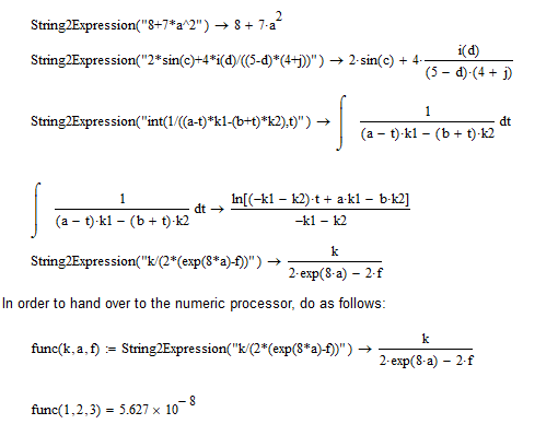

As said, the expression (variable or function) to string conversion is not available in Mathcad, although it has been asked for.
The other way around was found over 10 years ago , but only works in mathcad 11 (not before, not after).
This is what it can do:
That way you can even import an expression contained in a string from excel, and convert it to a mathcad expression.
