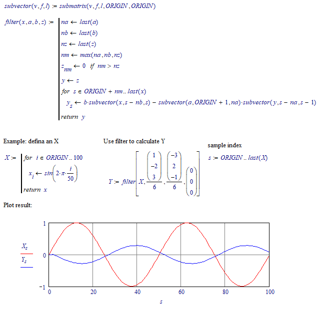

Does anyone know if there is a an equivalent mcad function to the filter() function in MathLab? Don’t think there is . See picture in attached file attached
I am looking at the standard SRS calculation but the recursive loop is not producing what is expected.

You're right 'filter' does not exist in Mathcad, but it should be possible to write it as a function.
thought so Smiley Sad
I had a 1st pass attempt at writing the loop for a well defined input signal but something's not right. I must have screw up the loop

LucMeekes
(To:JBlackhole)
Does this help?
thanks for the example. Looks it's me not being able to code the recursive scheme properly
LucMeekes
(To:LucMeekes)
I don't want to claim that this is a perfect implementation of the Matlab 'filter' function. It comes close in some respects, but it seems the output needs to be shifted to the left.
Perfection is a state of mind !
Not sure what is the problem. re-worked with use of vector multiplication (looks neater!) (idea from your post !)

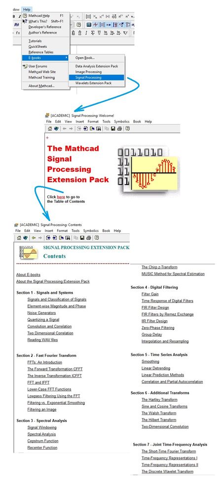

you can find something about analog and digital filters in mathcad help, see the picture below and follow the arrow .
Further more you can find something else again searching in the community worksheets.
Had a look at that obviously but found it not that useful. Maybe because I don't know exactly what I am looking for !
