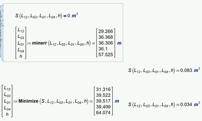

I would like to solve this problem
https://community.ptc.com/t5/PTC-Mathcad-Questions/Chebyshev-step-macine-optimization/m-p/500155
not with the Minimize function but with the MinErr function.
But do not know how.
Help me please!
The Mathcad 15 and Prime 4 files are in attach.
Whats wrong with minimize?
Anyway, here is the simplest way of doing it with minerr (you'll have to chose Quasi-Newton as algorithm to get the very same results as with minimze):

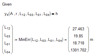

Just gave it a try in Prime4
You have no choice of algorithm
Calculation with minerr takes "endless" time
Result is not as good as the one derived with minimize

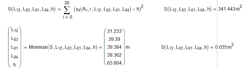

But I think about this method
I had not looked in your sheet and your equations in more detail and simply solved with minerr what you had solved with minimize.
You new approach seems to be different as you now have a constant h.
Why aren't you happy with your minimize results?

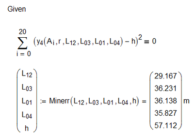

Thanks, Werner!
I see it too!
minimize
minerr
S=?

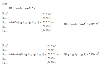

You defined S as the error function, so minimizing it gave your answers.
Find and Minerr act to satisfy constraints, so finding the minimum error for y(...) = h has the same effect.
Note that Minerr is basically Find where Find can't arrive at an acceptable solution. It's always wise to find out how bad your "minimum error" is, it can be quite unacceptable.
wrote:
S=?
Freds approach is basically the same as mine. So the result depends on the algorithm chosen (if you use real Mathcad and not Prime). From the values Fred is showing I guess he did not change the default (Levenberg-Marquardt) which (surprisingly, as LM usally ist best choice) gives a slighty worse result compared to Quasi-Newton or conjugate gradients (which s used by minimize).
