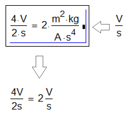

1. Actual, I calculate the Value of an inductance, the result is approx. 10µH.
The mathcad result is shown as 1 x 10-5 H. Can I format the result to µH ?
2. When I calculate the speed of voltage rise, I expect the result in V/s, but I get m2 x kg /( s4 x A)
(try to calculate 4V / 2s )
Is it possible to simplify the units?
Yes, you can.
Again yes.
Unfortunately you don't show which version of Mathcad you are using. There is a big difference between Prime and real Mathcad (Mathcad 15 and below).
Basically in both versions you can only set the unitsystem (SI, mks, CGS, U.S., ..) but not the units Mathcad choses within this system to display a calculation result automatically.
But you can change manually the units displayed for every single result and Mathcad will adjust the value accordingly.
How you do that differs whether you are using Prime or MC. In the first you simply overwrite the displayed units by the units you would like to see, in the second you would write the preferred units in the placeholder after the units.
Thank you, works great (I use MC15)
