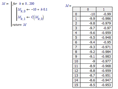

If you want that matrix, here's what you can do:
In the above program, k is a range used for the second AND the third purpose.
You should be able to get a table by entering:
C(z)=
and wait for the result..
