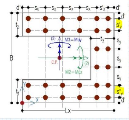

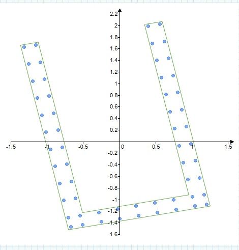

Dear community friends, I have a problem generating an automatic graph from the data of a matrix as shown in the spreadsheet. Mathcad Prime V.8.0.0

Tried the file with t1, t2, t3 set to 45cm in turn and found it does not plot OK.
Swap the definitions of S'y and S''y
That is S'y is associated with t1 and S''y is associated with t2
The enclosed versiom [v2] of the file is then OK
