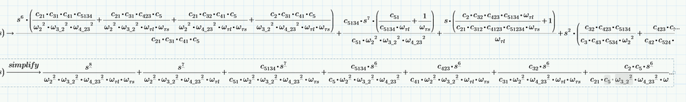

Is there a way to group or sort the power terms of a symbolic calculation in the increase of the variable "s"
Example: constant term+ a*s+b*s^2+c*s^3+d*s^4+....+k*s^n; where "s" is a variable
Right now the grouping seems to be random. You have s^6, then you have s^7 then you have s^2 see below:
See the N1(s), the last equation of this work sheet attached

Anyway, thanks for the helps. I tried your recommended approach and used "simplify" and it seem to work as compare to just an arrow--->
See below:
The advantage of using just ----> is all the s terms (s are variable and the rest are constant values) are factored outside the constants
Simplified works but then you have to manually group them
Please see the worksheet attached. I hope you can see it

Your sheet doesn't show what your picture shows.

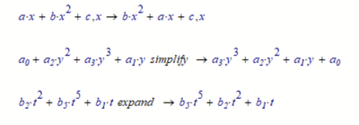

This may work in Mathcad 15:
If needed with a small tweak.
(To:LucMeekes)
It works in MC15 but the same results could be obtained using a simple symbolic evaluation, sometimes "simplify" or "expand" are required:

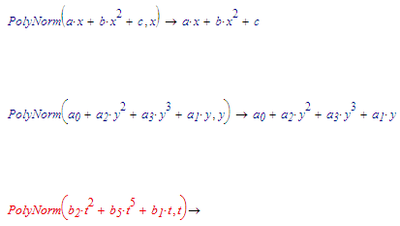

But  "Polynorm" fails at negative signs as do "simplify" or "expand". Thats the reason I suggested "collect"
