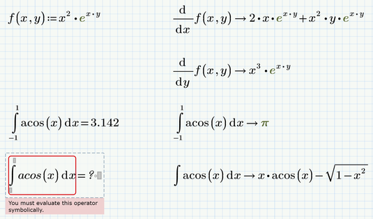

Let us see what you are trying to achieve by adding a worksheet with the erroneous regions.
Don't forget t mention which version of Mathcad or Prime you are using.
Given that you mention MuPad and labels in your error messages, I guess its Prime and version 6 or below.
On contrary to real Mathcad (version 15 and below) Prime has no special symbol for partial derivatives, you have to use the normal derivation symbol.
Indefinite integrals can only be evaluated symbolically.
Example file in Prime 4 format attached
