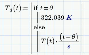

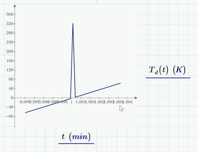

T(t) returns a temperature, t and theta are time, so the result of T.d(t) would be temperature * time. Is this really what its supposed to be? I guess - no.
If the "original" was done with real Mathcad (version 15 or below), then it had to be done without units because odesolve-blocks did not work with units. Thats the reason you won't expirience the error in that version.
I am not sure if it makes sense, but you could get rid of the time by simply dividing by s
But you have a discontinuity at 1 min, which may be the reason for the odesolve-block after its definition to fail with some kind of strange error.

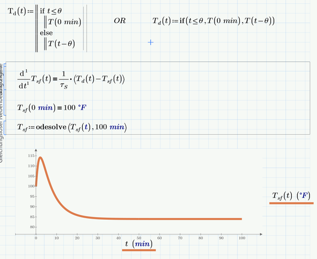

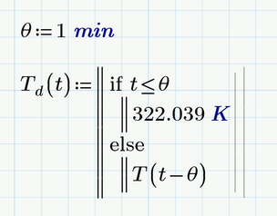

You mean something like this:
I guess it would be better to replace "322.039 K" by "T(theta)".

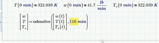

According the solve block: You have an equation for a function T.sf there which you do not solve for. get rid of it and the solve block should work OK:
Spoiler

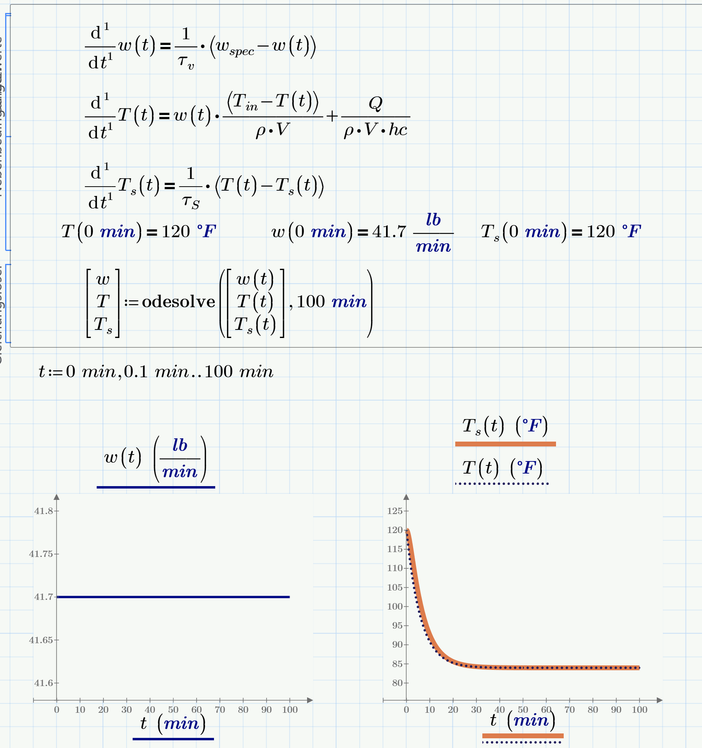

that is what I did in scenario 2. now i need to solve for Tsf in scenario 3. Do you think if I specify in scenario T(t) will it be able to read the value from last run in scenario 2?
(To:TN_9676358)
Whatever variable or function name you use, Prime will use the last definition of it.
But as you use T(t) as a function to solve for in your new solve block, Prime can't (and shouldn't) use last definition of it from the previous solve block.
I will remove the first 3 odes and will just define Td based on T(t) from last run. I hope it work

But the interval in the solve block for T must be a bit larger than the one for T.sf:
It has to do with the numerical derivatives the algorithm uses.
sorry i just read the message 😞 The graph I'm looking for looks differently. Im not sure what wrong. everything will need to start at T=120F. Do you have any ideas where am I wrong?
(To:TN_9676358)
You did not specify an initial condition for T.sf, so I used a random value (T.sf(0)=100°F).
Obviously you want it to change to T.sf(0)=120°F,
So Td and Tsf will start the first point at t=1, I specify the value of Tsf(0)=120F and they say the ODE range is larger. I believed for Td, because Td won't start until t=1, I think if t<0, there is no Td value.
Let me attached the new files for you.
I will need to specify both Tsf and Td starts at t=1 min.
