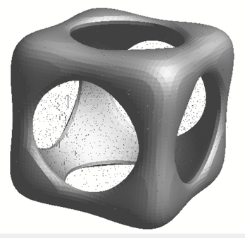

If I haven't got anything wrong, then this is where it all comes from.

When he posted implicitplot3D he gave a hint as to where the algorithm stems from (guess a similar one is used for 2D as well):
Idea: LORENSEN W. E., CLINE H. E.: Marching cubes: A high resolution 3D surface construction algorithm.
In SIGGRAPH 1987 (1987), pp. 163--169. 1.
Program author: (c) 2006-2007, All rights reserved, Uni Home Lab, Viacheslav N. Mezentsev.
