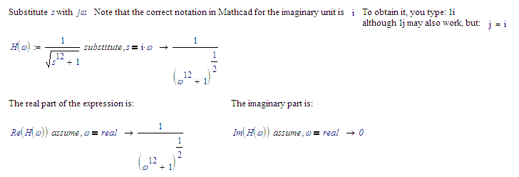

You are quite right. Invlaplace is not the right approach at all. What I want to do is to take an expression with s as the single variable and substitute omega*i  and then rationalize the result (i.e. convert the expression to an equivalent in real quantities) so that I can plot it. I think I have worked out teh syntax for using substitute, but I can't find anything about rationalization in the Help. Perhaps it's called something else

LucMeekes
(To:JohnWoodgate)
To substitute s with omega*i is simple:

Like this?
It could be the answer, but 's' should be 's/omega_c', where omega_c is a constant. The imaginary component should not be zero for all omega. I need to check with other expressions in s that seem to give wrong results with other software.
LucMeekes
(To:JohnWoodgate)
I assume your omega_c is a (real) constant. Dividing s by it does not make a big change, and it certainly will not help in getting an imaginary part for the total expression. Note that you raise s (or s/omega_c) to the 12th power. Since that power is an even number, and with s replaced with j*omega, you're effectively raising j to the 12th power. That will make it real.
If, however, you keep s as a complex number (with a complex and a real part, both non-zero) you will get a real and a complex part for the total expression.

LucMeekes
(To:JohnWoodgate)
Í don't wish to spoil the fun, but the expression is its own magnitude:
