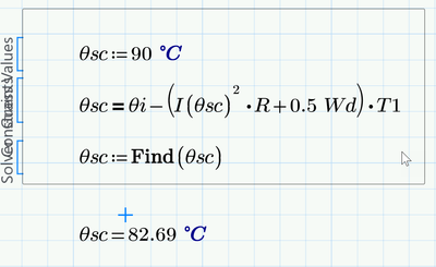

As now, in midst preparing the power cable ampacity calculation, somehow, required loop calculation process at the end section. Here it goes.
1) Assume the θsc (pic 1)
2) Then several calculation in the middle to get the ampacity value. (pic 2)
3) Once current (I) value obtained, the θsc required to be calculated as per red mark above.
4) When θsc calculated, it required to be linked and to be used as input in item (1) above (and so on until) the θsc in item 1 and item 2 comes with 0 difference.
5) Calculation sheet as attached.
Thanks.

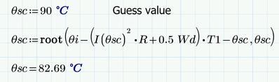

OK, there are four calculations which depend on thetasc and you have to turn these into functons of thetasc.
Then you can use either a solve block or the "root" function to do the iterations for you:
Hope that the attached sheet helps.
Remarks:
The root function can also be used without providing a range (I used 9°C to 90°C) but using a guess value:
And her for completeness sake how to do it using a solve block

Any idea for automated iteration setting instead of manual way in mathcad?
Here how it shall work... (some idea for you).
Red circle - guess/assumed value.
Then calculation process will use the red circle value to compute all the formula till green circle value obtained.
Then, green value shall be used in red circle for next round of computation until the red and green value difference approach zero.
Hope to hear from you soon.
Remarks:
