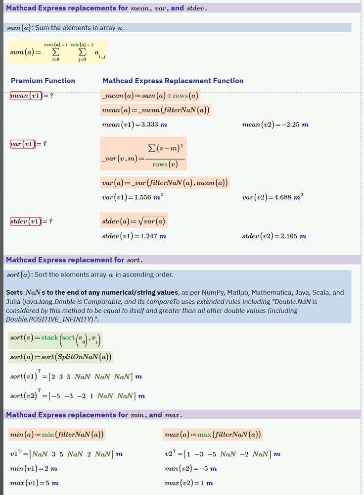

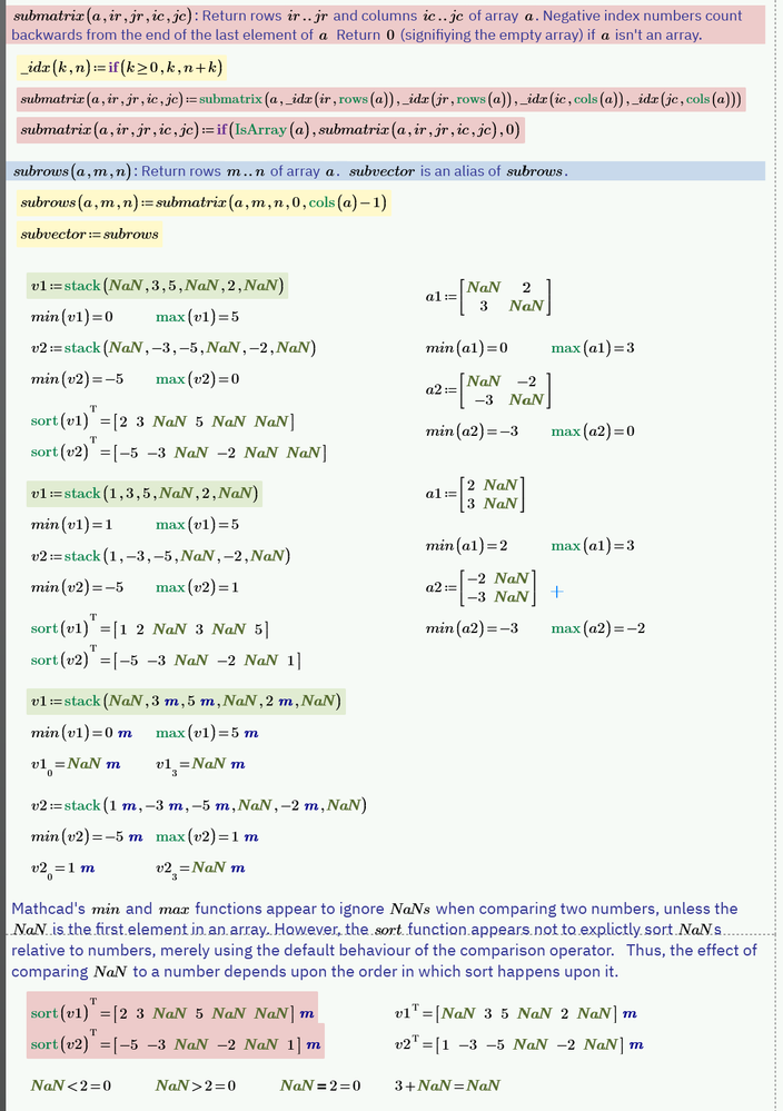

I was searching for other threads that mentioned problems with the min function and found this thread.  Out of idle curiosity, I emulated the indicated "problem" in Mathcad Express 11.
As filterNaN is a Premium feature, I had to implement an Express version.  I chose to do this via a general filter function.
Which I then used to provide substitutes for mean, var, stdev, sort, min, and max.
I chose to sort NaNs to the end of the sorted vector, as this seems to be the preferred method used by a number of other mathematical and general programming languages.
