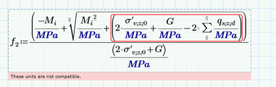

Both of the variables have the same unit, however mathcad said units are not compatible why is that?
Formula does not have consistent units.

LucMeekes
(To:YA_10963798)
If Mi is in MPa, then Mi^2 should be MPa^2...
So either square the MPa under Mi^2, or divide Mi by MPa before you square it:
(Mi/MPa)^2.

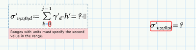

one more question. How to solve the following error ?

LucMeekes
(To:YA_10963798)
So, that's Prime 9.
You shouldn't evaluate a definition like you did:
(That is: do NOT put an = at the end of a definition. Yes, it works, most of the time, but it also causes trouble, more often that you wish for.)
So do:
Now exactly what are you trying to do?
you set up a summation with k running from 0 to j-1, but j is a vector because you defined it as a range and used an inline evaluation at its definition which transforms the range into a vector (undocumented behaviour that should be used with caution, if at all). Now Prime will not allow the upper limit of the summation index to be anything other than an integer scalar. So that's your problem 1.
The other problem is that your summand
(The stuff you want to sum), does not use the index k. So what is Prime supposed to do?

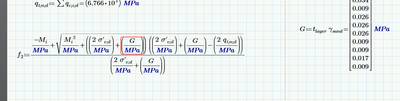

I'm having the same issue again

(To:YA_10963798)
The sheet you attached shows a different error compared to the picture you posted above where only G(MPa is highlighted red.
I see you opened a new thread with that question and I already answered it -> https://community.ptc.com/t5/Mathcad/units-are-not-compatible/m-p/945030/highlight/true#M211406
Please also note my last answer there because I think that you don't need to divide by the units at all but you have to apply vectorization to get the desired correct results.
