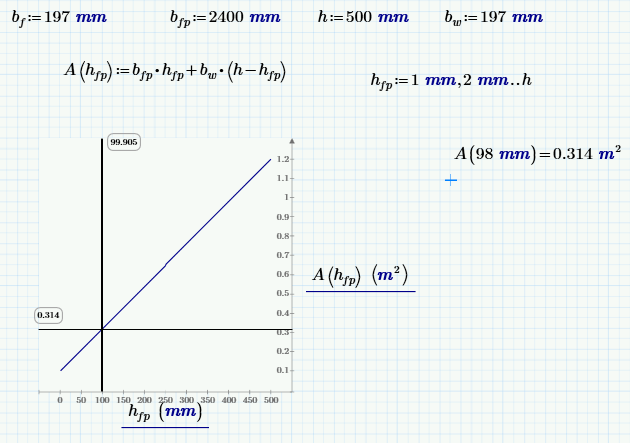

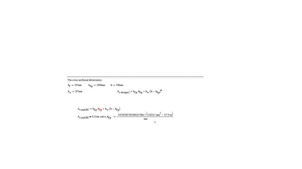

what is this?? could anybody tell me? i just want the simple answer..Bez tytułu.jpg

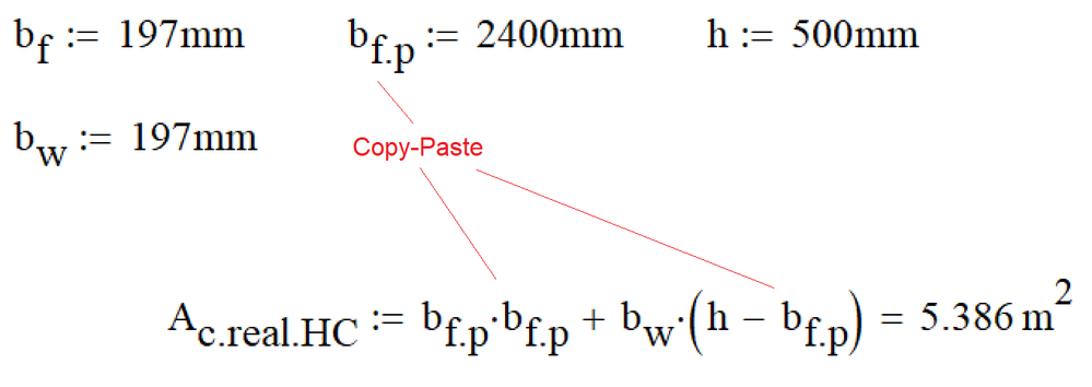

Try
I think (I can't really read your picture too well) that you need meter squared in your constraint.  But that poses another issue--Mathcad symbolics doesn't handle units well
