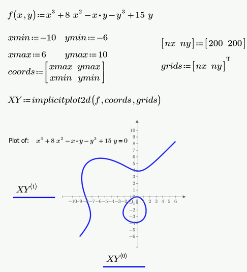

BTW, there actually exists a utility function "implicitplot2d" which was posted here by user uno (Viacheslav  N. Mezentsev) quite some time ago, but it would be overkill to use it for the linear function you show.

Not out of the box and the method you may use depends on the equation. As already written above the linear equation you give as an example is quite easy as you simply can solve for y and plot and, as Luc has shown, you may let the symbolic solve do this simple task.
But for more complex equations that cannot be solved uniquely for y, this method is no longer appropriate. Here the function kindly provided by Viacheslav N. Mezentsev can be very helpful, as shown in the picture below.
Prime6 worksheet attached.
