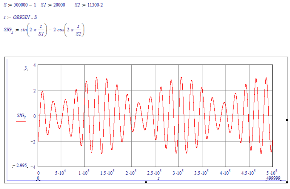

How many points? Mathcad 11 is limited to 500 000 points in a plot.

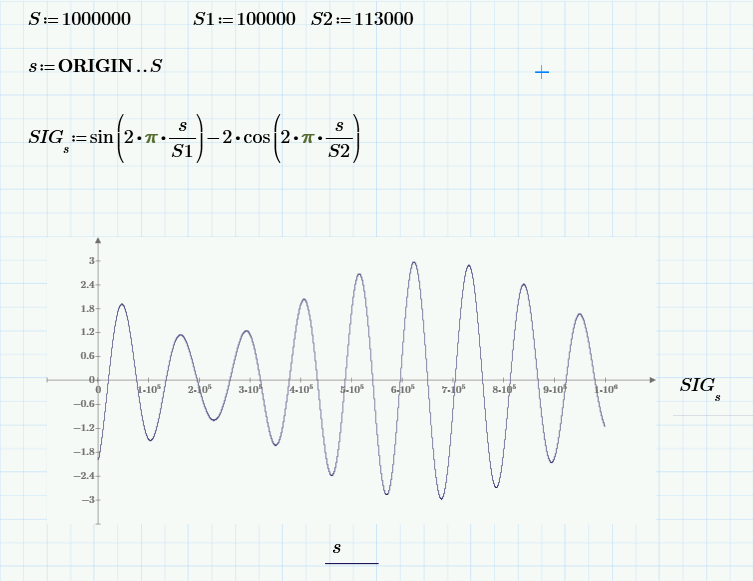

I have a plot with 1 million points in Prime 4 (on 64-bit Win10), and can still edit trace colour.
Notice that in order to edit trace properties, you have to select the (Y-axis) variable (SIG[s in the above example) in the plot that you want to change properties of.

Where the number of plot points in mathcad 11  is limited to 500 000, it is limited to 2 000 001 in Prime4. I get a warning when I try to exceed that number.
This seems like a reasonable number (in fact the half-a -million is also resonables, considering thst you cannot actually see every plotted point for a plot containing 16 traces with 31250 points each (that makes the total 500 000), as every point on a landscape A4 would be less than 297/31250=> 0.01 mm.  You really cannot see that.
