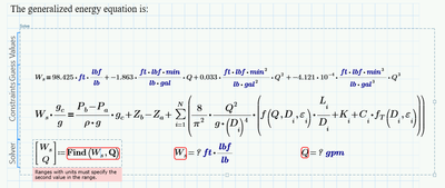

Even though I have declared two values for all variables that are iterative Mathcad Prime 8 is still pushing this error "Ranges with units must specify the second value in the range",
please advise and thank you!

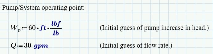

Need to define N and make variable W[p not W[s which is defined as a vector earlier in the sheet then it works
Don't forget to alter guess variable name to W[p

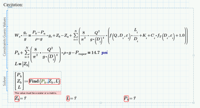

Hi thank you for your help, having issues with this part now.
(To:JR_9175191)
