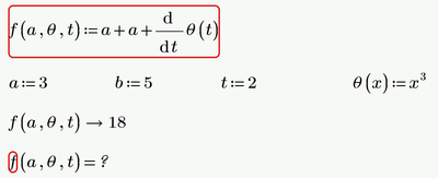

In this case I want  to allocate a result of substitution to Eq1,
It seems to works for the substitution but  then Eq1 seems undefined. What happens?
Then it might be the reason why the 2nd substitution is endless.
However, when i try to make 2 substitution in the same execution command, it is endless too.
What happens  ?  Is there a relation between those 2 cases ?

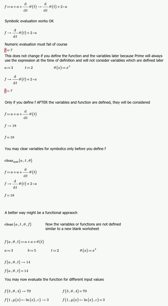

(To:FB_10651590)

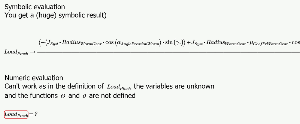

You try to evaluate Eq1 numerically (the normal equal sign). Here Prime throws an error because of the derivative of the unknown and probably undefined function Theta.
Numeric evaluation will only return numeric values, not generic functions or their derivatives.
Not sure what may cause the "endless" calculation. Its hard to impossible to debug just a picture ...

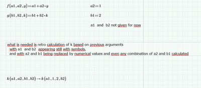

(To:FB_10651590)
You must realize the difference between numeric evaluation (=) and symbolic evaluation (->)
Here some remarks using a simpler example
BTW, even in the last approach a derivative won't work (IMHO it should, but maybe its because Prime would have to do the numeric derivation at definition time which it can't  because the function is unknown at that time?)
nor that way

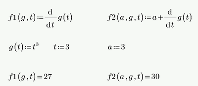

Hmm, one more thing broken.
Mathcad 11 does:
(But would not allow:

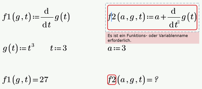

(To:LucMeekes)
It look like its a new Prime 10 bug!
It still works OK in Prime 9
Prime 9:
Prime 10:
Error message means "A function or variable name is needed".
I can see no meaningful reason why f2 should fail but f1 would work OK.
Cornel
(To:Werner_E)
Can You try in prime 10 this: f2():=a+f1(), and then evaluating f2 function to see If in this way it works?
(To:Cornel)
Yes, that's a workaround but it should not be necessary to do so.
I still consider the behaviour in Prime 10 to be a newly introduced bug which should be fixed by PTC!
Fortunately this bug seems to not affect the main question in this thread.

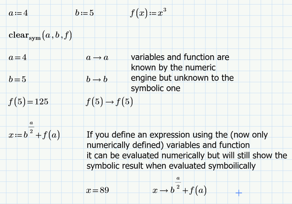

(To:FB_10651590)

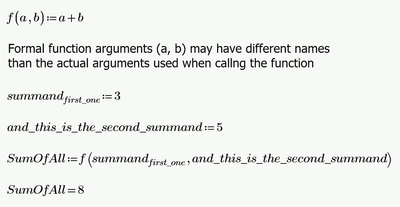

Again - any expressions. either typed in or derived by a symbolic operation like "solve" is static in the sense, that variables defined later will not be replaced in that expression if you evaluate it.
Only way out is to define it as a function.
As already shown you may define variables and functions but make them inaccessible for the symbolic engine.
That way you can make an expression evaluate numerically using the numeric evaluation (=) and still have the symbolic result at hand if you evaluate it symbolically.

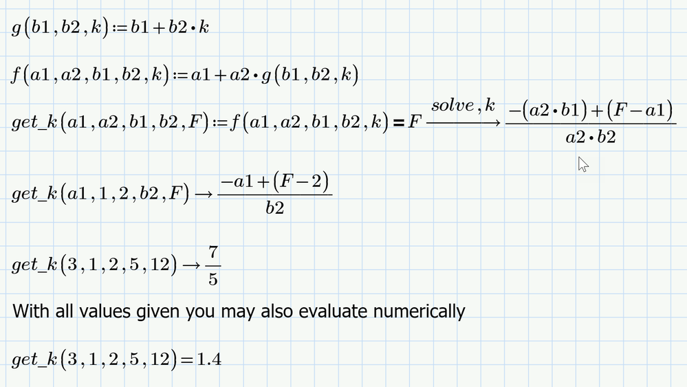

(To:FB_10651590)
"At the end, I need to see better which are preponderant terms of the formula and understand better how it behaves."
Exactly for this purpose it is MUCH better if you define a function with parameters. Elaborating on Werner's example with:
you can have the numerical result:
or another one:
AND you can see how a specific variable is handled, such as a:
or b:
And if you do NOT clear the symbolic for f:

(To:FB_10651590)
In your example the value of k would not only depend on a1, a2, b1 and b2, but also on the value given by function f. I call this value F in the screenshot below.
You could do as follows:

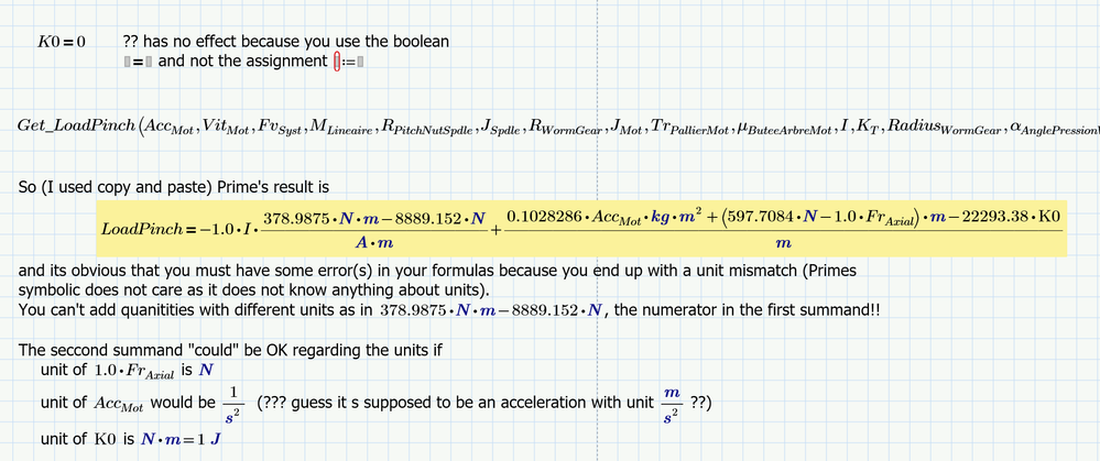

I try to follow your example, but very quickly it says there is no solution, although I am sure  there is one
(To:FB_10651590)

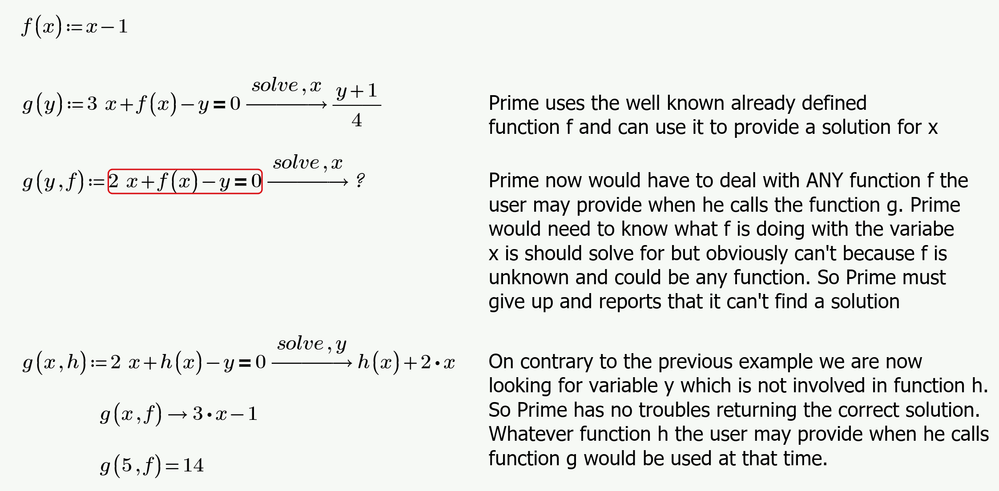

Don't ask me why, but Prime fails because of the function Load.axial in the parameter list.
Maybe because the solutions does not directly depend on that function, but the logic behind that failure is not really clear to me at the moment.
But anyway, once you delete Load.axial from the parameter list of your function get_LoadPinch..., Prime is happy and returns a result:
EDIT: OK, I guess a have a logical explanation for Primes failing when you apply the function name as a parameter. Doing so would you enable to provide different functions Load.axial. But Prime tries right ahead to find a solution even though now the function Load.axial is unknown. But this function has the variable you want to solve for as an argument and because Prime does not know what the function looks like its quite clear that it can't give a symbolic solution.
We would need some kind of late evaluation which triggers the symbolics only when the function is called with a specific function Load.axial as its argument, but this is not an option in Prime.
Here a simplified example

The problem here seems that you still have undefined variables in the expression (probably only I) and so you have to use the symbolic evaluation.
On the other hand you run into the inability of the symbolics to deal with units and so it can't simplify expression with different units, which actually may cancel or can be collected.
Can you post the sheet so we  can see if we could find a workaround?
You could try to (re)define some units at the top of the sheet - maybe in a collapsed region.
E.g. the symbolics does not know about "deg", but if you define deg:=pi/180 (deg should be labelled as unit), the symbolics will numerically evaluate the cos(20 deg).
Same applies to lengths units. When you define mm:=10^-3 m (mm again should be labeled as unit), the symbolics will simplify all lengths to meter. If you define m := 10^3 mm it will default to mm.

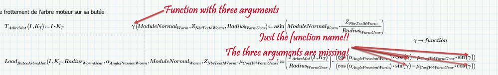

The last expression yields something like sin(function) and I tried to find out where this may stem from but I got completely lost in your (for me) much too large expressions with all those lengthy variable and function names. All I could see is that this strange expression also occurs in the definition of your function get_LoadPinch but I was not able to trace any further.
I guess I can't be of help anymore here...
EDIT2: OK, I couldn't resist 😉
Found the root of the problem:

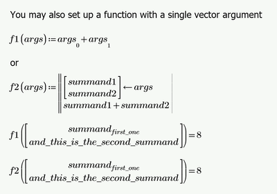

Here some thoughts which may help tiding up the worksheet, making the expression a bit shorter and maybe better readable:
You may of course combine the methods, create a function with two or three vector arguments, etc. - whatever seems appropriate.
(To:Werner_E)
After fixing the aforementioned problem with gamma we get a symbolic result, but there are one or two unit problems you'll have to fix!

I am new to Prime  but finding the error seems a litttle complex,
the case of the 3 arguments of Gamma was not easy to find as not clue from Prime.

It wasn't easy for me, too because of the large expressions and variable names.
Prime's symbolics can't give any clue because it doesn't see it as an error.
If you define a function and evaluate just the function name, all information you will get is that its a function.
This is exactly what happened when you used just the function name gamma.
Only when you provide function arguments the symbolic will evaluate the function using the definition
