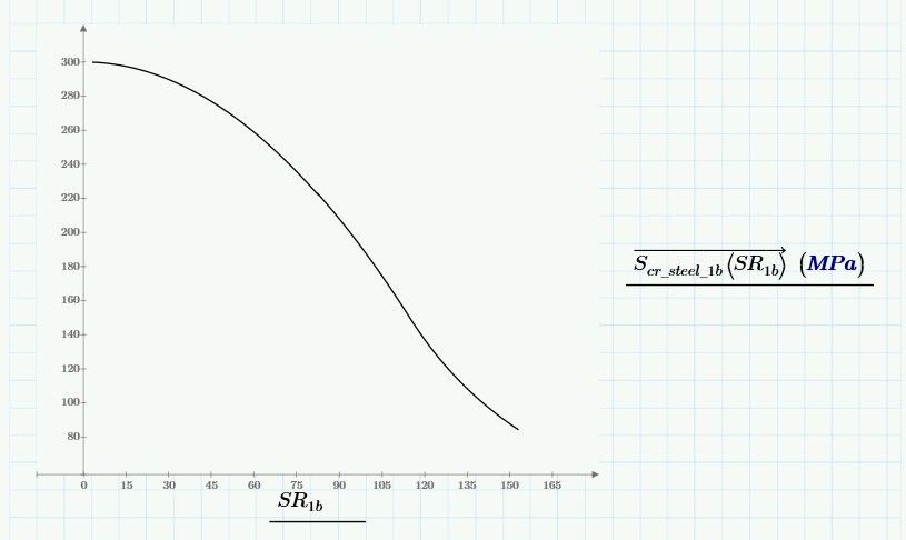

Define SR_1b as a range variable. For example:
SR_1b:=0,1..100
and then your graph works.

SR1b is a vector, so vectorize the expression on the y-axis
