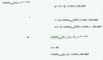

This?
1*exp(-1j*t) makes it.

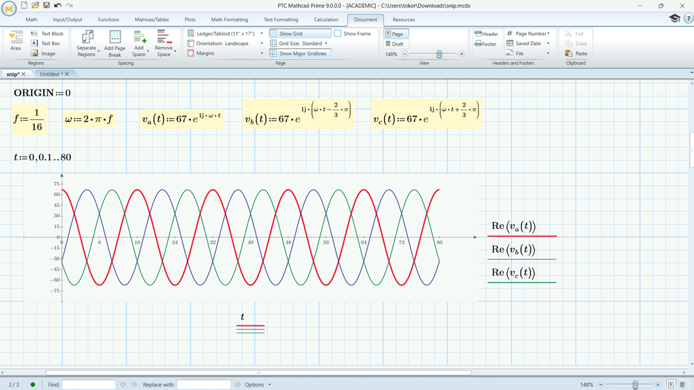

Hi ttokoro,   can you share the file showing how you plotted the phasors?
My file is Prime 9. You can copy and past one by one from P9 to P8.

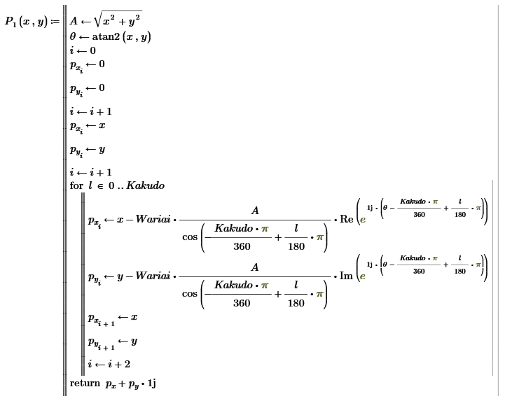

How did you get the arrow heads on the phasors in your plot?  Thank you, i will try to convert.
One example here
