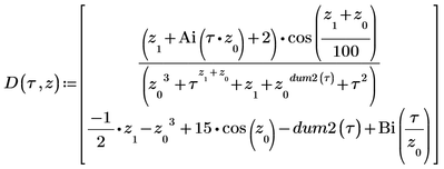

Has anyone got an example of successfully getting sbval to work?
I keep getting :
I am playing with a 5th-order non-linear system.
Many thanks in advance!
Solved! Go to Solution.

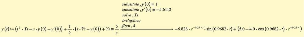

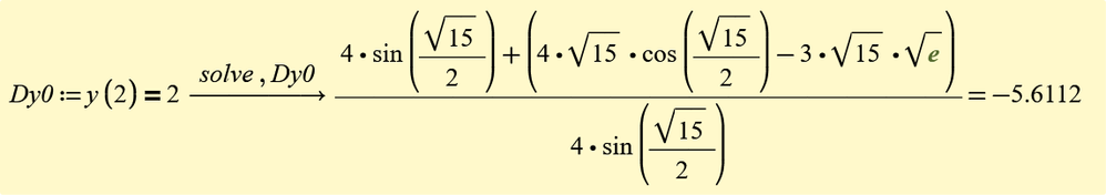

Thanks ttokoro, this is a nice compact way of solving linear de in Laplace form. Would it work if you had one initial condition - like y(0)=1 and the other boundary condition say y(1)=2 ?
Yes, but it takes one more (set of) equation(s) to solve.
See attachment.

You can solve ant y(t) value.

Hi, Many thanks for the references - they helped steer me in the right direction. I tried to break sbval using a really tricky D matrix (no idea what it represents) using:
Remarkably, sbval found the initial conditions to satisfy boundary conditions - see attached terse worksheet. By playing with additional changes I could switch between - "cannot converge" and my original error message - but it was not clear what was causing the switch. But everyone's help showed me that I was at least using sbval correctly and that the problem resided in my D matrix somewhere. I finally got sbval working by non-dimensionalizing the differential equations - which may have cleared up an incipient fault with units that I could not see.
Many thanks for the rapid response from everyone!
