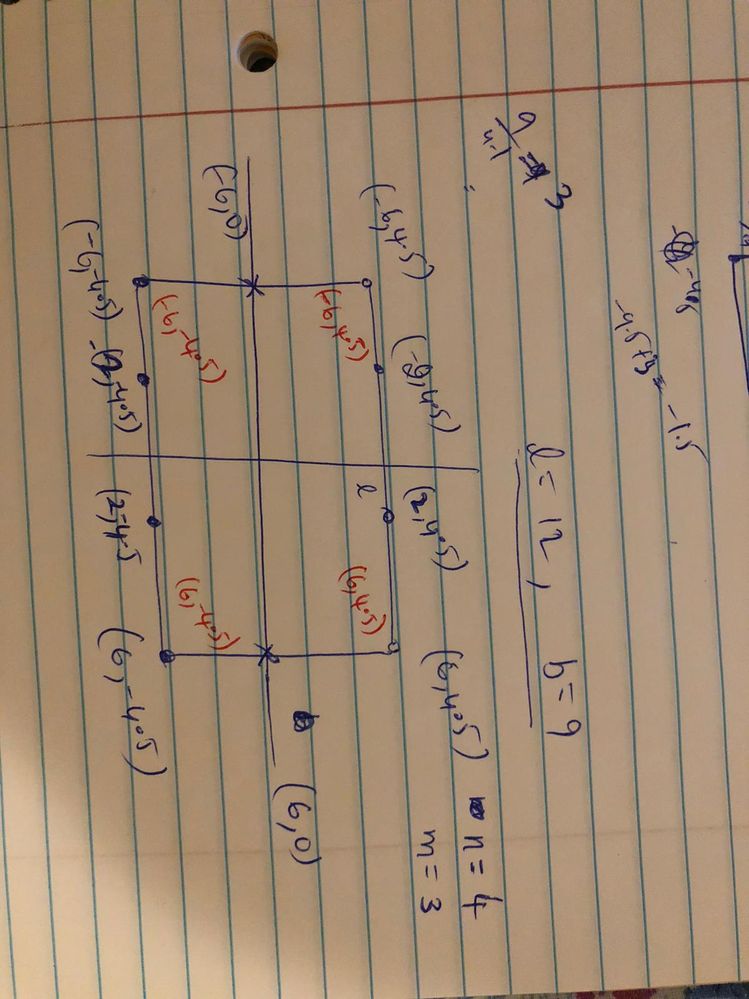

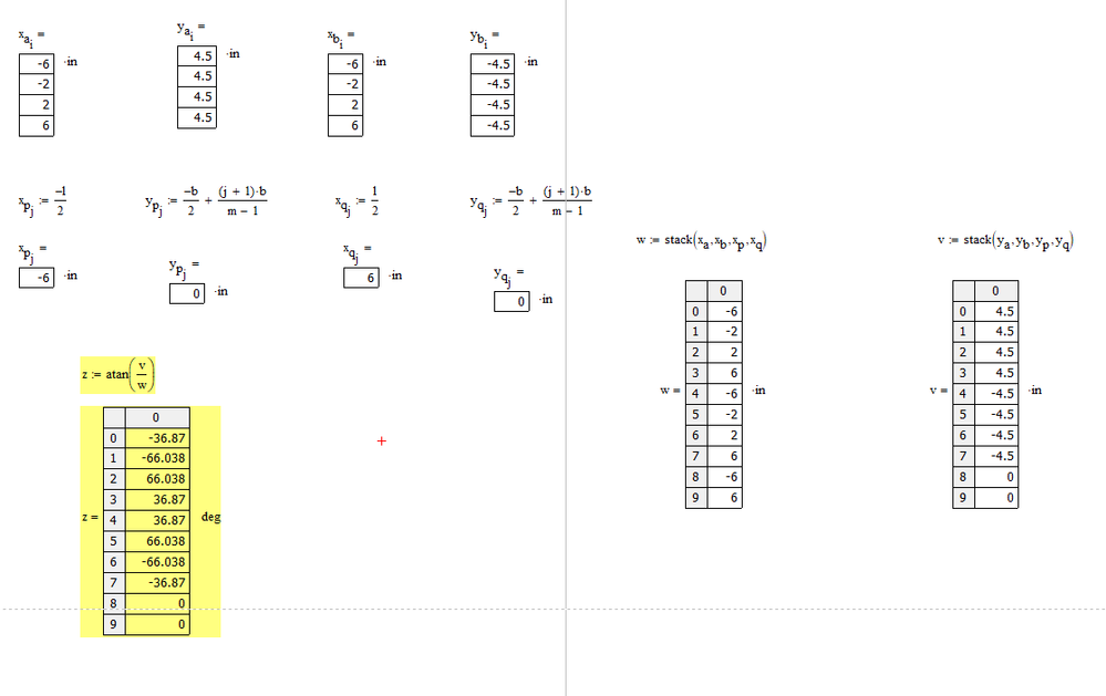

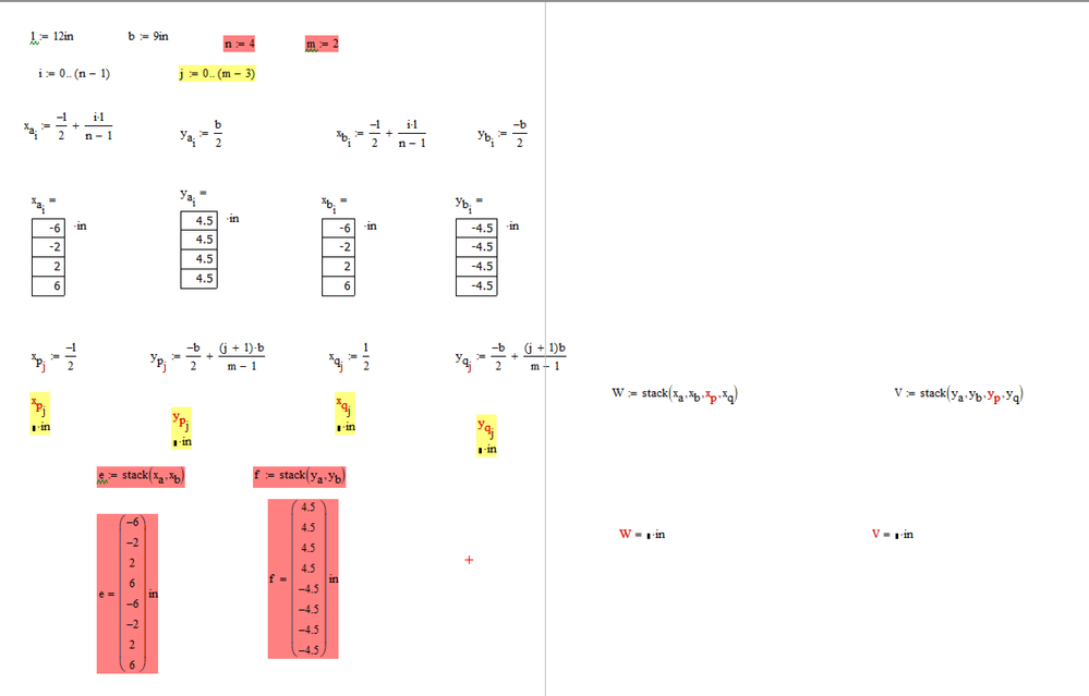

Hi, I was trying to stack all the x coordinates together and all y coordinates together. I see an additional value (0,0) in the result w and v. Can you please tell me why is the additional rows generated and how to eliminate it. And i am using mathcad 15
Thank You.

Maybe because you started indexing at 1, while the default start index is 0?

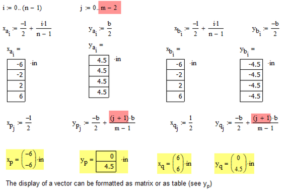

Luc is using Mathcad 11 and so he can't read your file. With MC15 you can resave the file in MC11 format, though (something which is not possible with Prime). I attach the file in MC11 format here.
Attaching the worksheet usually is a good idea and quite often simply necessary. But its also a good idea to attach a screenshot, too 😉
Lucs guess was correct. The setting of ORIGIN in your sheet is the default value 0, so every vector starts indexing with number zero. You created a range variable j which started at 1 and assigned values. So vector element with number 1 gets the correct value 4.5 in, but there still exists a vector element with number 0. This is not assigned a value and so its set to zero by default.
To display the vector y.a you typed y.a[j= which only gives you the elements defined by range j, but not the full vector. If you simply type y.a= you see the full vector with the leading zero.
Rule: If you use a range variable to define vector this range should start with the value of ORIGIN.
Here a small example to demonstrate what happened:

Thank you for the explanation i was trying to eliminate the set of coordinates which are repeated. They coincide with the vertices of the rectangle, by starting the index j from 1 i wanted to eliminate the repetition. can you suggest me a way to remove the repeated coordinates?

Note sure what you mean. Which vertices, which rectangle?
Do these changes address your problem?

Thanks for the idea it helped me get what i needed. When i changed the value of m=0,1,2 the j value becomes undefined. so can i give "if" command to consider e and f instead of w and v if the m is given less than 3??

@rizz12 wrote:
Thanks for the idea it helped me get what i needed. When i changed the value of m=0 the j value becomes undefined. so can i give "if" command to consider e and f instead of w and v if the m is given 0??
You get the error because when m=2 you try to use a vector index of -1 (m-3). You can't use a vector index lower than the value of ORIGIN (which is 0).
I guess you could use something with an if construct when you create xp, but I have the feeling that the vectors you are after (guess they are lists of coordinates ?) can be calculated much easier than the way you try to do it. But unfortunately I have no clue what exactly you are trying to do, maybe you'd like to explain in more detail.
Are you trying to get a list of the m x n coordinates if you divide a l x b rectangle into (m-1) x (n-1) smaller rectangles? But if thats what you are after then n=4 and m=3 should give you a vector with 12 coordinates, not just 9. So maybe you are looking for something else.

the coordinates are the bolt location. i am trying to calculate the forces on them. based on the formulas i have given earlier some coordinates were coinciding. so i was trying to eliminate them. if m is less than 3 the j becomes undefined and stops the calculation. so i was trying to use e and f function by using if statement in case if m<3 and want to make the j index terms zero.

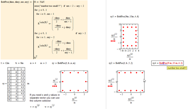

Guess I got it.
I would prefer to write a more generic function to do the job:
Mathcad 15 worksheet attached

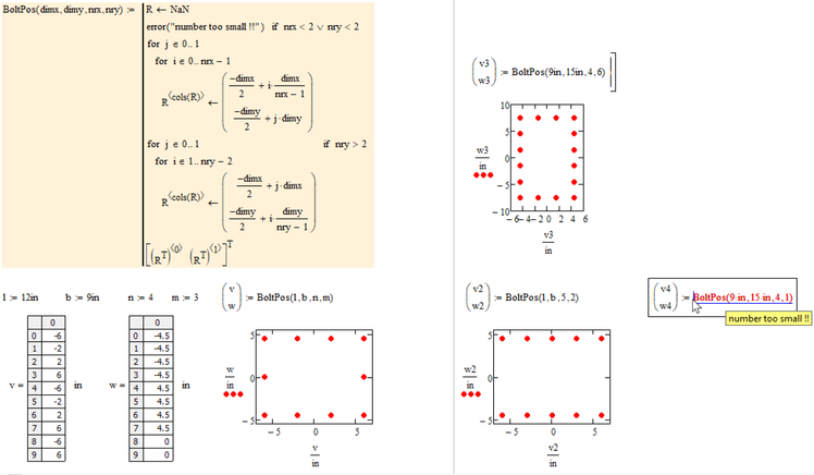

Think it would be better if the functions returns a 2-column matrix instead. Your choice anyway.

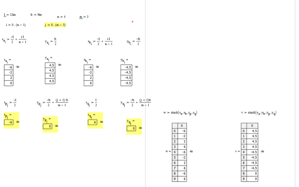

hi, W works when i give values greater than 2. Is there anyway we can make W work if m<3 by giving conditions the j indices values xp,yp,xq,yq = 0 when m<3.

Your approach only works if xp and xq are valid variable which have been assigned a value.
Fortunately there is a simple solution. You have to make sure that the definition of xp and xq does not fail and so you have to avoid that the range j runs into a value below ORIGIN (0). You only have to define the range j a little bit different: j := 0 .. max(0, m-3)
In this case, when m<3, j becomes a range from 0 to 0, which is valid also for indexing a vector. And your if statement later makes sure that in the case of m <3, the unnecessary values of xp and xq are not included in the vector W.
You may also use the if-function instead, even though its not that clear in display: W:=if(m<3, stack(xa,xb), stack(xa,xb,xp,xq)). Guess its a matter of personal taste - I'd prefer the way you did it.

hi,can you tell me How did you position the coordinates as points instead of the connecting lines for the coordinates (W,V)? and can the point indicate which bolt its referring to?

Double click the plot (or chose from the menu Format-Graph-XY-Plot), select Tab "Traces" and under "type" chose "points" instead of the default "lines". Then you may chose a "symbol" and its size (-> "Symbol Weight").
