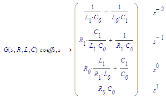

 You may want to try the symbolic keyword collect, if that still exists in Prime 6. Example:
And to get the coefficients of all powers of s in vector form, try coeffs.
(To:LucMeekes)
Unfortunately using the original "G" from the provided sheet, both "collect" and "coeffs" return expressions too large to display.
At least with "coeffs" a workaround could be to assign the result to a variable and evaluate the elements of the vector singly:

Thanks for the helps. Looks like your version of Mathcad did it. It is able to factor out the terms. As Werner mentioned, using Collect and Coeffs in Mathcad 6.0 results in the expressions that are too high entropy and it is hard to understand what it means. Please see attached
