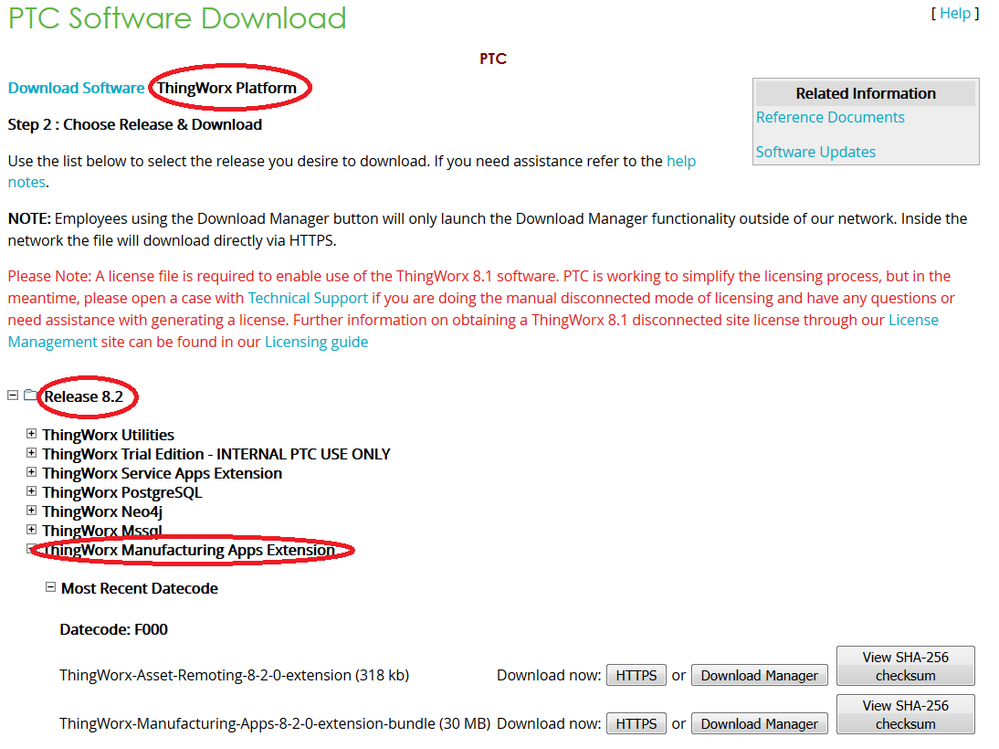

slangley
(To:stmarchessault)
Hi Tahsin.
ThingWorx Manufacturing Apps 8.2 was released yesterday and can be downloaded from PTC Support:
Support.PNGPlease refer to the product announcement for more information.
The express/developer versions (freemium editions) are available on the ThingWorx Manufacturing Apps Portal
