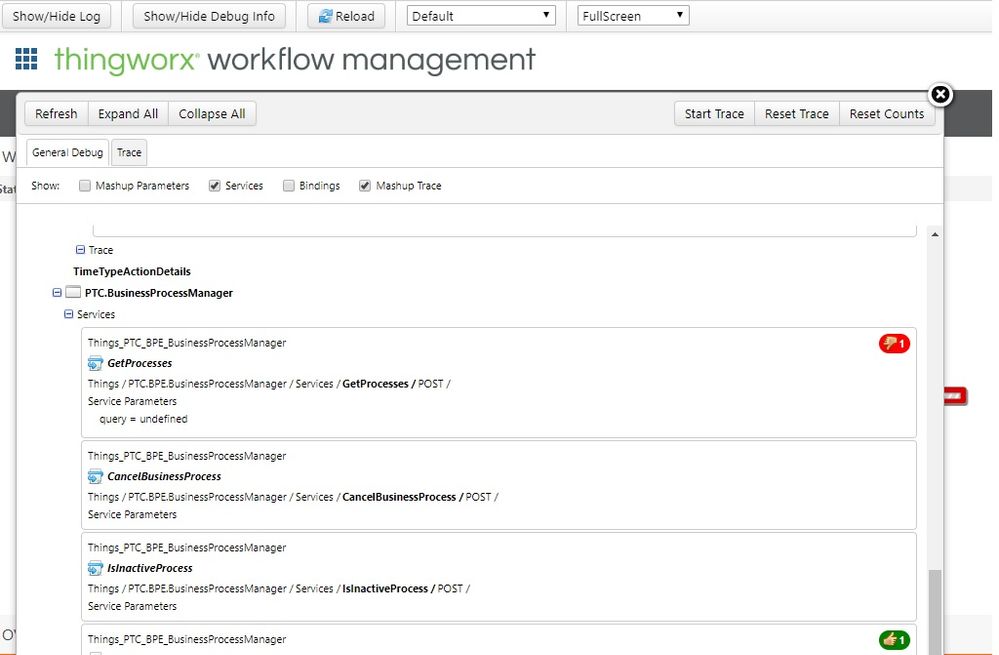

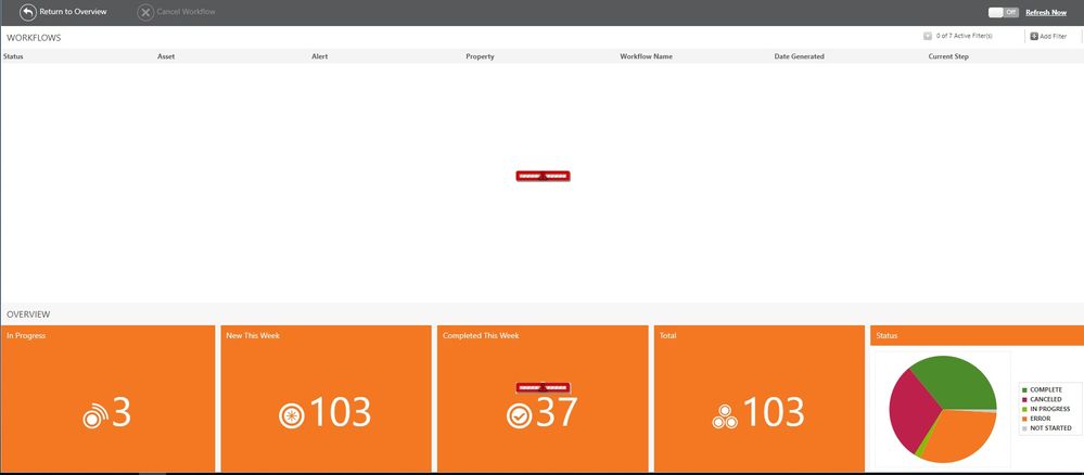

Hello.
ThingWorx Workflow Manager does not show a list of threads at startup.WF_err_01.jpg
Log:
12:07:02 INFO  - In-page logger initialized.
12:07:02 INFO  - ThingWorx Mashup Runtime vundefined
12:07:02 WARN  - trying to set a parameter that is not defined: "forceClose".  Ignoring it
12:07:03 WARN  - trying to set a parameter that is not defined: "forceClose".  Ignoring it
12:07:04 WARN  - trying to set a parameter that is not defined: "forceClose".  Ignoring it
12:07:05 ERROR - Runtime exception handling data update for binding {"SourceArea":"Data","TargetArea":"UI","TargetSection":"","SourceId":"GetProcesses","SourceSection":"Things_PTC_BPE_BusinessProcessManager","Id":"afec42a5-674b-4fb0-856c-78952a9c2f76","PropertyMaps":[{"SourcePropertyType":"InfoTable","TargetProperty":"Data","TargetPropertyType":"property","SourcePropertyBaseType":"INFOTABLE","TargetPropertyBaseType":"INFOTABLE","SourceProperty":""}],"SourceDetails":"AllData","TargetId":"Grid-19","isBoundToSelectedRows":false}
Exception: Cannot read property 'length' of undefined
12:07:05 ERROR - Runtime exception handling data update for binding {"SourceArea":"Data","TargetArea":"UI","TargetSection":"","SourceId":"GetProcesses","SourceSection":"Things_PTC_BPE_BusinessProcessManager","Id":"1911c081-6d36-428e-8274-22b7d3187de6","PropertyMaps":[{"SourcePropertyType":"InfoTable","TargetProperty":"Data","TargetPropertyType":"property","SourcePropertyBaseType":"INFOTABLE","TargetPropertyBaseType":"INFOTABLE","SourceProperty":""}],"SourceDetails":"AllData","TargetId":"InfotableSelector-70","isBoundToSelectedRows":false}
12:07:05 ERROR - Error in invoking service Things_PTC_BPE_BusinessProcessManager, GetProcesses, Things, PTC.BPE.BusinessProcessManager, Services, GetProcesses. Error from the server: "Unable to Invoke Service GetProcesses on PTC.BPE.BusinessProcessManager : null"
12:07:06 WARN  - runtime not configured for conversion from "INTEGER" to "NUMBER" propertyMap: {"SourceProperty":"NumberOfColumn","SourcePropertyBaseType":"INTEGER","SourcePropertyType":"Property","TargetProperty":"number_of_columns","TargetPropertyBaseType":"NUMBER","TargetPropertyType":"property"}
12:07:06 WARN  - runtime not configured for conversion from "INTEGER" to "NUMBER" propertyMap: {"SourceProperty":"NumberOfRow","SourcePropertyBaseType":"INTEGER","SourcePropertyType":"Property","TargetProperty":"number_of_rows","TargetPropertyBaseType":"NUMBER","TargetPropertyType":"property"}

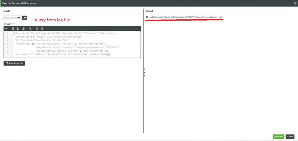

Can I fix this?
I'm a fix problem.
For clear list of WorkFlow need execute a service PurgeDataTableEntries in PTC.BPE.BusinessProcessDataTable.

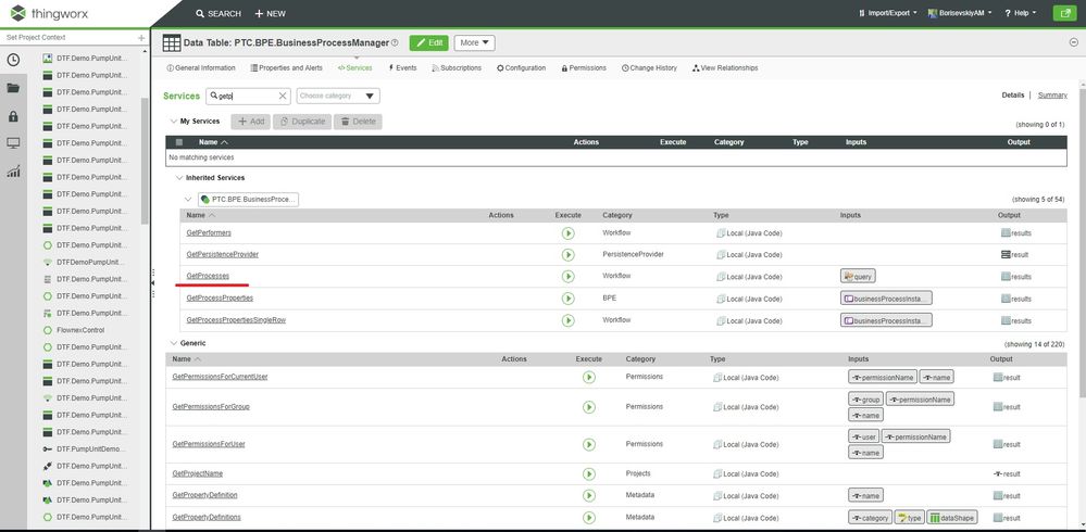

Hello.
Log's attached.
Other WorkFlow are launched under the same user.
Steps for error search.
I think somewhere requests should be stored. They need to be cleaned.
Two requests in the log file give an error.
ThingWorx 8.3.3-b937
I'm a fix problem.
